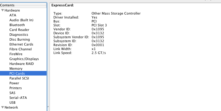

So here's where I am today. The system profiler recognizes the esata card:

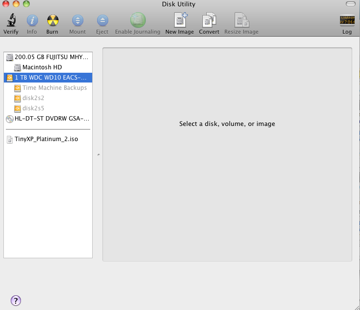

But the external drive refuses to mount and when I check in the disk utility, it sees the drives but then the application itself freezes.
it's important to note that the drive works fine when connected via USB.
