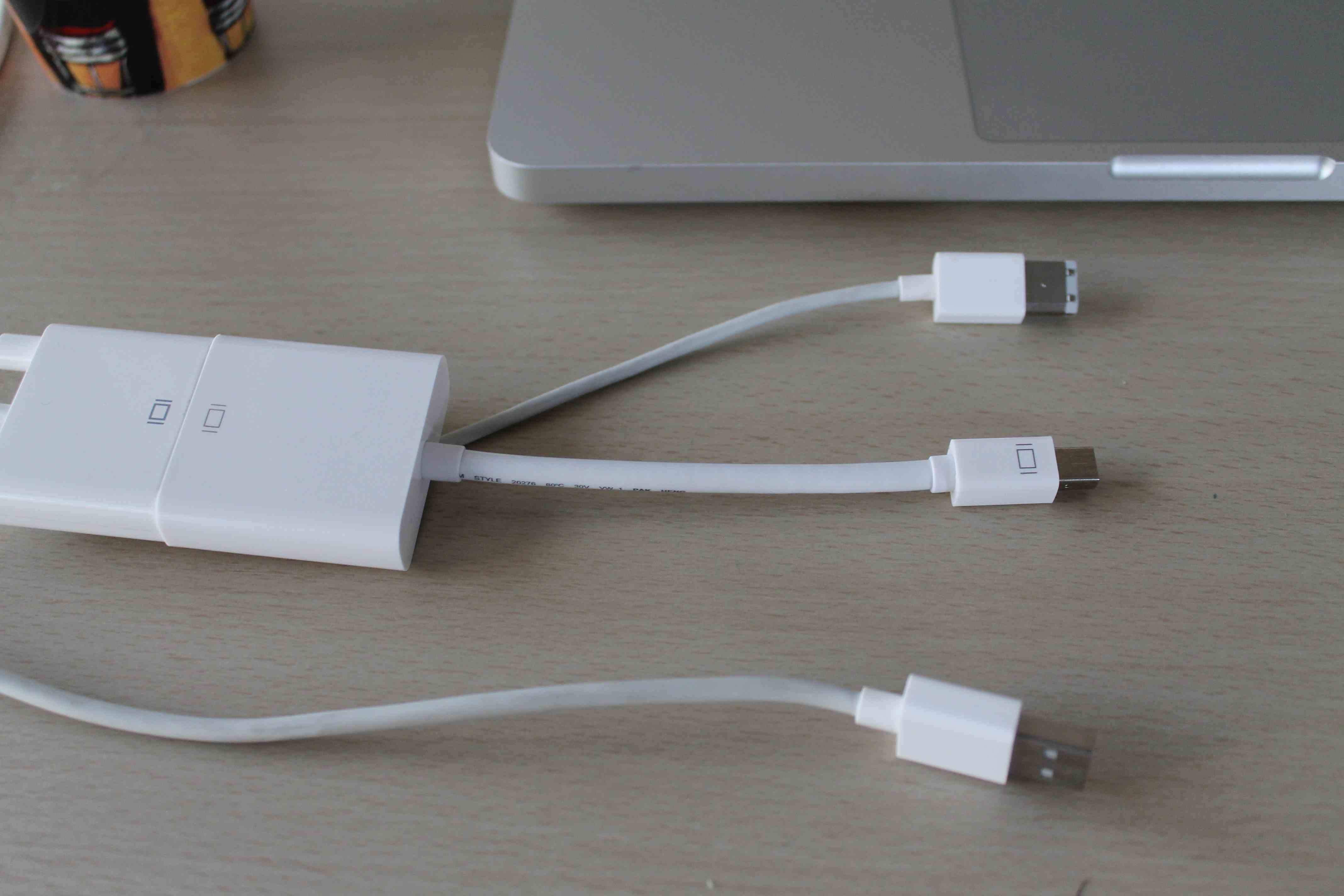

Don't they have ADC connectors rather than DVI? Surely you'd need a (rather pricey) ADC->DVI connected to mDP->DVI....

I would rather post a pic -- cuz I didnt buy it from Apple. See the attached picture.
I'm going to have to suggest it's the adapter. I've purchased multiple 3rd party adapters and out of 5, two didn't work.

I dont wanna challenge the quality of this adapter -- cuz my brother bought two, one for his imac and the same 20 inch ACD, works fine. So, the odds of this adapter fail is quite low. But, still, appreciate your suggestion.

Why don't you ask to borrow your brother's adapter and try that on your computer just to rule it out?

Just because you buy two of the same thing, does not mean both are of the same standard/quality or in fact, working.
For a quick update anyone else suffering the same connections issue, I just bought a new mdp to dvi adapter, works perfectly.
