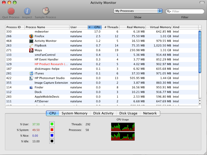

Alright so it did it again, only it went to 80c this time. The fans didn't even key in, so they stuck at around 2000rpm, so I manually adjusted them to 6000rpm temporarily, which helped... I had a few more apps open, but I wasn't really even using any of them (including Maya, which would heat the computer if I was using it). And also to note I wasn't charging my computer at the time. All this was about 20 minutes ago. I have since quit all the apps besides Firefox (of course), and it's currently at 60c (with fans back down to "default" 2000rpm)
Any ideas?
Thanks guys
Edit: another thing I just noticed is that the numbers for the cpu usage don't add up properly. Down at the bottom of the image it says that its using something close to 90% of the CPU (user and system combined), while above in the list is shows that not even 25% of the CPU is being used. hmm, what's that all about?
At the top of activity monitor, where it says My Processes, change that to All Processes and you will see everything that is running (you might need the admin password to see all processes).
