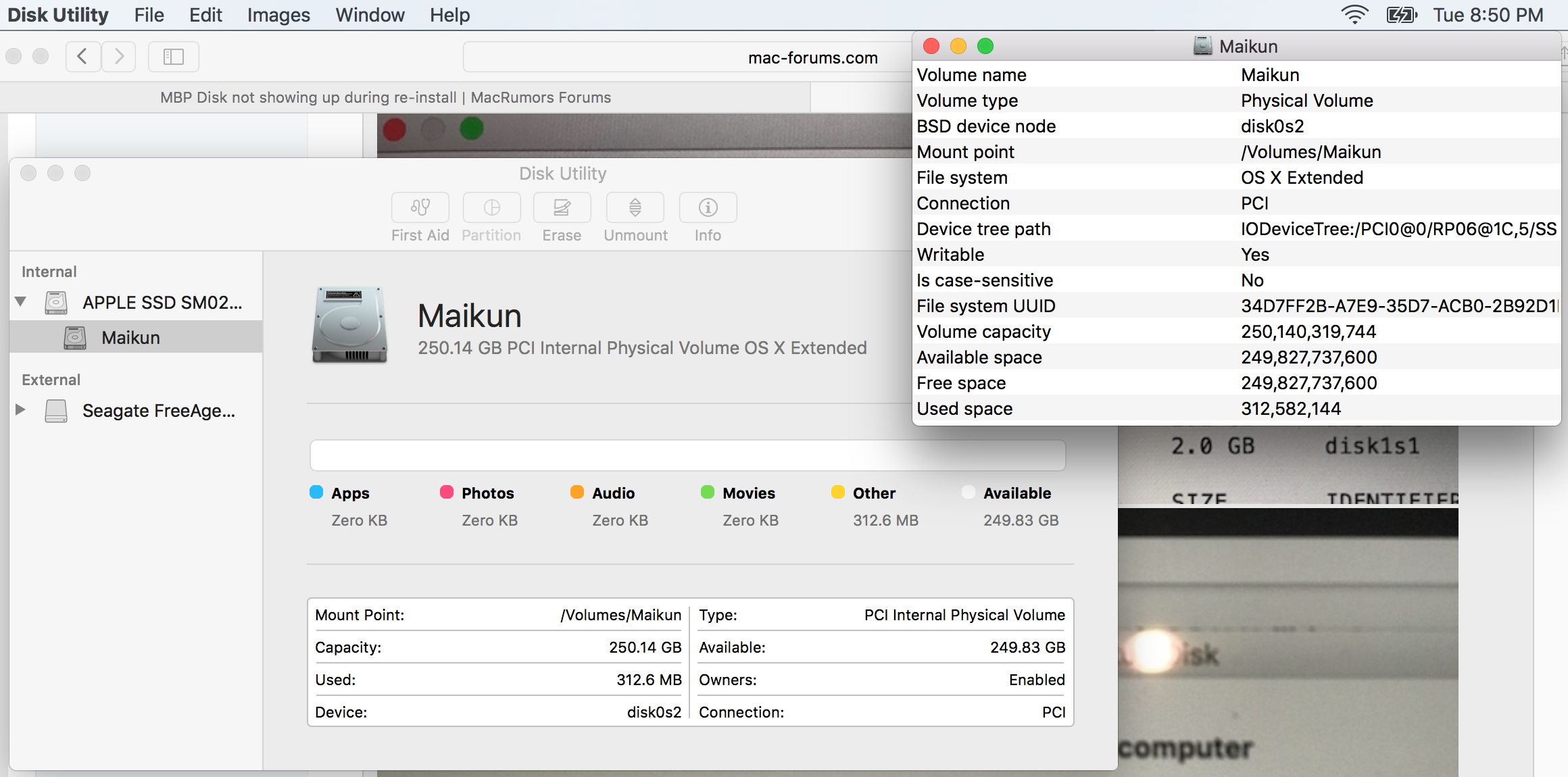

I managed to install a working copy of El Capitan onto an external HD and that is what I'm using now. Using this I can see my MBP internal disk in Disk Utility. I ran first aid and it appears fine.

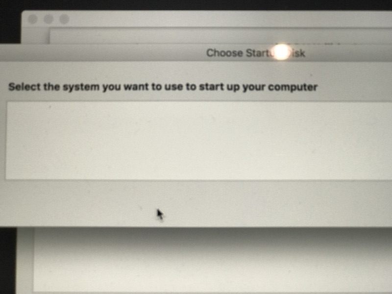

The problem is it does not show up (select destination) when I try to re-install OS X from the internet recovery option and it does not show up when I try to restore the system from Time Machine. Only the drives in the USB port show up.

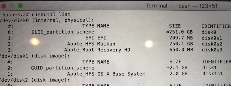

I think you might get some useful information by using the terminal diskutil command.
From the recovery mode can you launch Terminal and enter the following command:
diskutil list
And post back the results?

Heres a picture of the window where the internal drive normally shows up. It's not there so I can't select it to do anything.
I included a screen shot from the disk utility when using the external drive. You can see the internal drive is there.

That’s helpful.

OK so you should be able to use the diskutil command to erase the drive ready for partitioning etc.
do man diskutil
Would need to work out the commands, but I think the below erases the entiredisk and creates a new volume called 'Test'. My hope is that you can then create a volume that is visible and usable.
diskutil eraseDisk JHFS+ Test /dev/disk0
