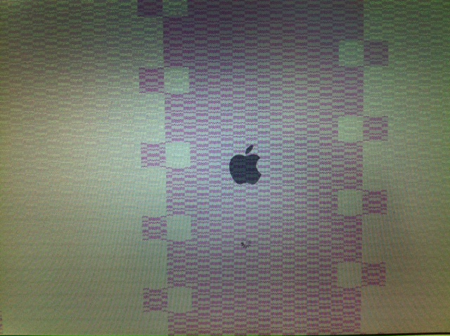

Hello,
I switched on my MBP this morning and the start screen looks strange. I attached a picture. The MBP doesn't boot any more, it showes this screen and the turning boot sign which stops after a few seconds.
I connected my image and pressed the option key. My image appears as a bootable devices. I select it it in order to boot from. The same problem happens again. The boot sign turns a few seconds longer but stops again and everything freezes.
I tried the same as well by pressing C but the same. I installed a few days ago a bootable recovery partition with techtool pro 6. But can not boot from it as well. The same problem as with the image.
My DVD drive doesn't work for ages already. So I didn't try to boot from my snow leopard install disc. Not sure if it is worth to get a usb cd rom drive to boot from the snow leopard drive?
My MBP is an early 2008 model and I am running snow leopard.
Does anybody have an idea. I am realy desperate.
Thanks

No, no option at all. Apple must replace the logicboard of your machine. I've a similar problem with a Mid-2009 MBP. 😡
If you want to know more about the problem:
http://www.theinquirer.net/inquirer...s-apple-macbook-pros-nvidia-bad-bump-material
Well, if the logic board is indeed the problem, it should be possible to take the hard disc out of the machine and plug it into another computer (easiest using an external enclosure). Should be another mac probably so it can actually read the filesystem.
That was the method which i used to "rescue" my files in a similar situation. Quick and effective. I can recommend it.

Thanks a lot for the map. I had the same problem with the Apple site, not very helpful for Dubai.
I know some of these shops but they don't repair as far as I understand. Do you know if one of these shops repair and where I can bring my MBP and get it repaired foc as my MBP is still not 4 years old ( assuming it is a NVidia 8600 GPU failure)?
Unfortunately not. I'm not from Dubai. 😱
However:
iStyle (3rd on the list on the left side of the map) says, they have also a "out of warranty repair center", which sounds like what you need. You can show them this:
http://support.apple.com/kb/ts2377
if needed.
Another company from the above mentioned "Dubai list" is E-City. The E-City customer support statement sounds like they provide also AASP-services:
http://www.ecityuae.ae/customer-support
