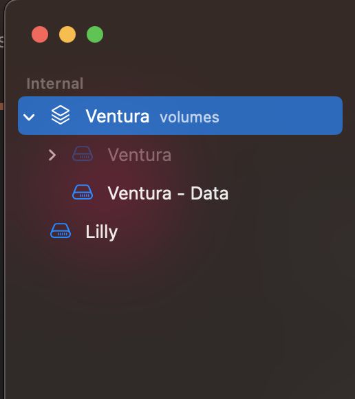

From my understanding the Ventura volume is a separate entity. I've made a screenshot below. It's a good idea to create another volume and attempt a restore, unfortunately space won't allow for it. The Mojave section is around 750gb and the Ventura one is the rest. This is my primary reason for considering doing this. There's about 200gb actual free space give or take and I don't want to wear the internal ssd any more than necessary at this stage in it's life.
It's a little hard to tell (see below) but it looks like the "Lilly" volume is in the same Container as "Ventura volumes", which I think is a Volume Group. IIRC Mojave did not use Volume Groups -- that came to macOS later, so this makes sense.
If you care to, you can clarify the setup to yourself by going to the View menu item in Disk Utility, and selecting "Show All Devices" (instead of the default, which is "Show Only Volumes"). Then you can select any line in the left pane and the top of the right panel will tell you if it's a Physical Device, Container, Volume Group, or Volume.
