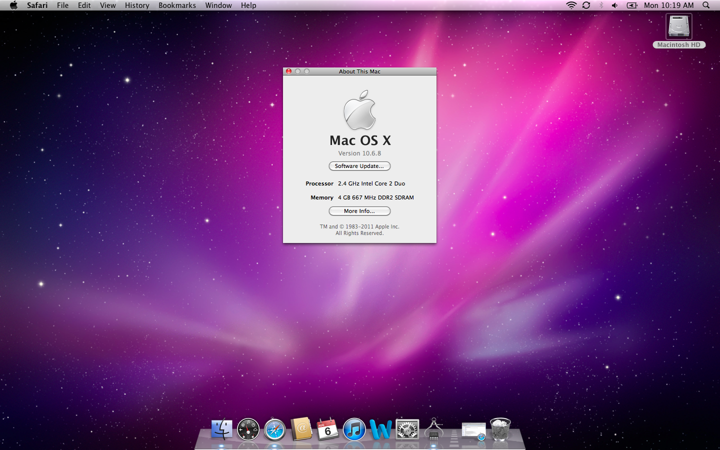

Related question that for some reason I've been unable to answer: I have a a 15" 2.4/2.2 GHz (which I gather is technically distinct from an Early 2008; "About This Mac" screen shot attached, just to confirm). I replaced the HDD and RAM last year and it still runs fine, but the battery (my second with this laptop) is completely shot.
Which battery should I buy to replace it:
1) this or 2) something else?
You can find specs on all Apple products:
That one should work.
