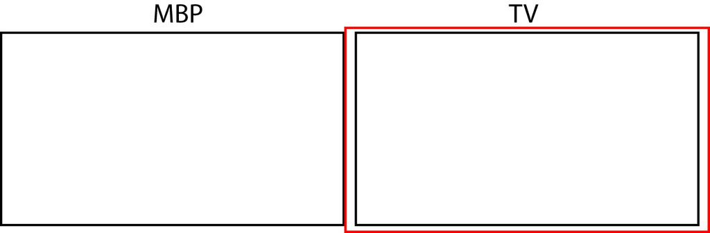

I will draw up a quick visual to help understand the problem.

The red box is the size that is being displayed while the black is what is viewable.
