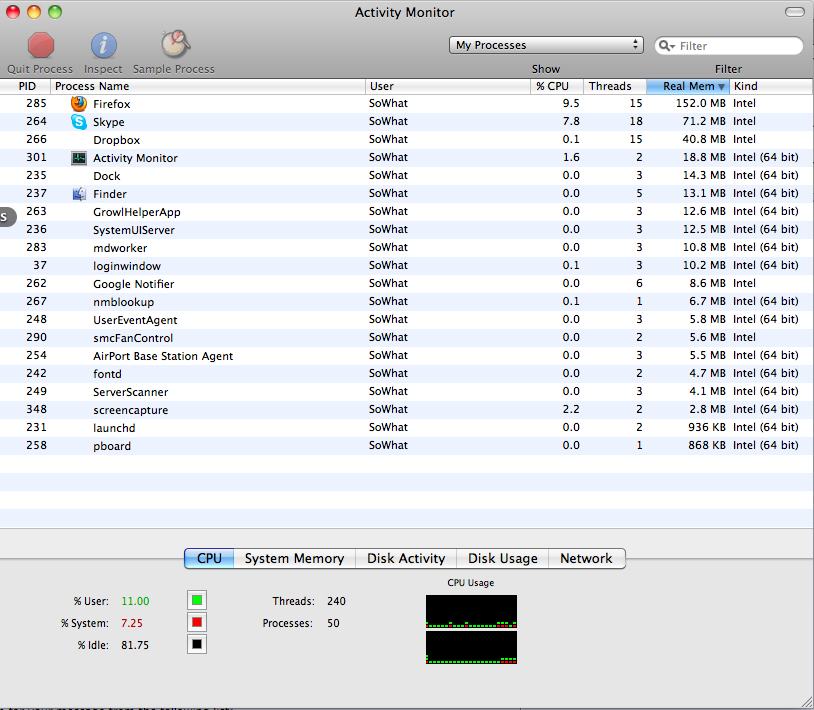

Here is screen shot from Activity monitor when fans are at 2000rpm:
Here when 6000rpm:

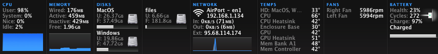

Here are results from idle temp.
It is so low, because fans are working on very high rpm. And I bought the best thermalpaste I could get Arctic Cooling MX-3 :)

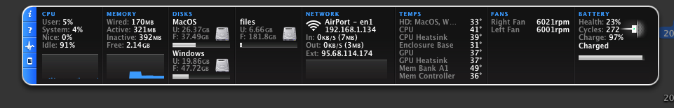

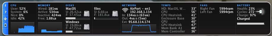

and here is almost full load

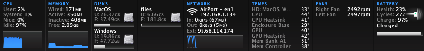

and here is normal idle temp. at 2500rpm:

OK I understand, your CPU seems very cool because your fans are running so fast.
Just one comment, your "almost full load" picture shows only one CPU core at maximum, not both. There is 42% idle which is nearly one whole core. A good way to get both cores to maximum is to open 2 x terminal windows and type yes > /dev/null into each one. That starts 2x endless CPU loops. What does iStat Pro show then?
I looked hard at your temperatures, they look OK but there are a few funny things...
1. Memory Bank 1 seems very hot. Hotter than the CPU, the GPU and the heatsinks? That seems unlikely. Memory does not generate very much heat. Where is all that heat coming from?
2. The GPU heatsink seems to be hotter than the GPU, and hotter than the CPU heatsink. That seems very strange. Where is that extra heat coming from? I would expect to see the GPU heatsink perhaps 5 C cooler than the GPU, maybe similar to the CPU heatsink.
It looks like you have done a good job on the CPU thermal paste, the CPU and heatsink temperatures are different by 15 C at about 50% CPU load. That seems OK, mine is 20-25 C at 100% load, with the standard Apple thermal paste. (unibody MBP 13")
I think maybe something is funny with your GPU cooling, and possibly your memory cooling. I don't know if it is a sensor, or your thermal paste, or something funny with the heatsinks/fans. I do not know if this is enough to cause your fan problems, but it can't help. I can imagine it is possible that the fan control algorithm has got confused by the GPU heatsink being hotter than the GPU, or the memory being very hot.

OK, so your CPU and CPU heatsink temperatures are different by 24 C, that's the same as mine so seems OK.
Same picture
- your memory always seems to be at 48 C, whatever the Mac is doing. Strange. My uMBP does not report the memory temperature, so I don't know what to expect.
- your GPU heatsink is hotter than your GPU & hotter than GPU heatsink.

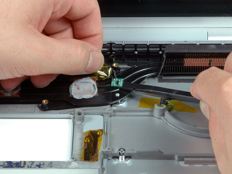

I opened my Mac, found GPU Heatsink sensor, disconnected it, iStat showed a line instead of temperature, so I am sure that this was GPU heatsink sensor. Connected it back, now iStat shows temperature again, all sensor wiring looks good, but my fans are still at 6000rpm.
Maybe problem is in Mem Bank A1? Where this sensor should be? I am sure, that it isn't on RAM, because ram plates are much colder than CPU and GPU.
Edit: Probably problem is somewhere else, because RPM jumps up before Mem Bank A1 has reached 40 C

I have red all results from Google yesterday, but I didn't find anything useful :( They all end with suggestion to take Mac to the dealer, but no solution to the problem.
Here are current temperatures from opened Mac
As you see, heatsink temperatures are normal.
After reconnecting sensor, HW test still shows same error.
That was a very good idea to disconnect sensor and run hardware test - now I know that Th1H isn't the sensor on heat pipe, because when I disconnected it, HW test reported error TG0H.
After disconnecting sensor which is sticked to aluminium under fan, I got back old error, so probably this is the broken sensor (I hope).
My HW test from OS X 10.4.8 install disk 1 doesn't tell any additional info, maybe newer versions reports something more.

Another thing I noticed is that changing the thermal paste didn't make any difference to your CPU vs heatsink temperatures. Yours was 25 C and so is mine with the standard Apple paste. I am even more convinced that changing the paste makes very little difference to CPU temperatures. Apple's factory does a pretty good job. All this talk about swapping the paste to Arctic Silver or whatever is just a myth.
