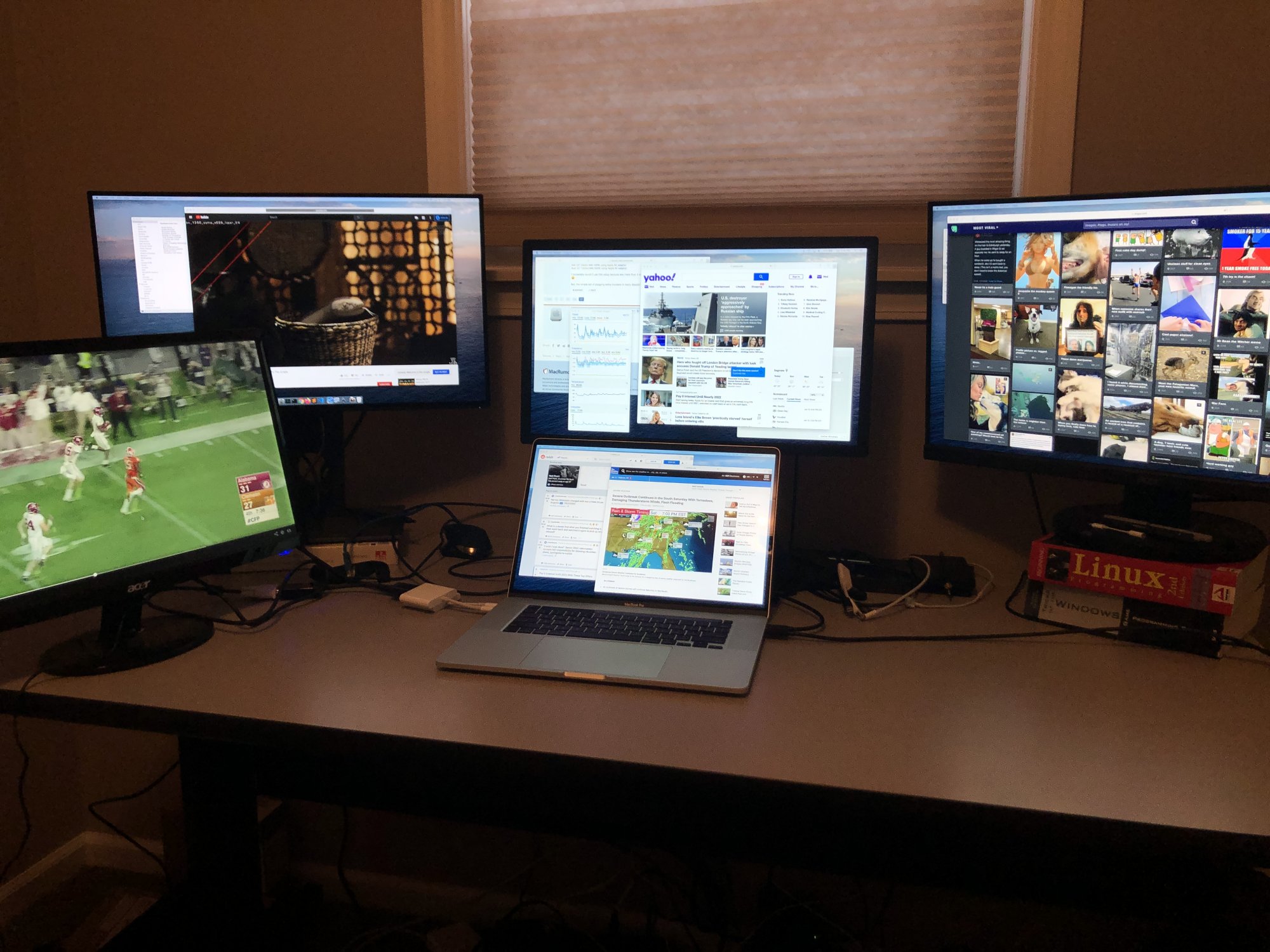

4 work with the 16”

Wow what adapters/peripherals did you use? Seems to be running quite a lot of stuff, performance issues or fans running like crazy?
I just used some usb-c adapters for whatever monitor it was (min DisplayPort, HDMI, one monitor is a 4K LG USB-C)
at idle it’s fine, but if you start using an app heavy it gets warm of course - whether you have one monitor or four
