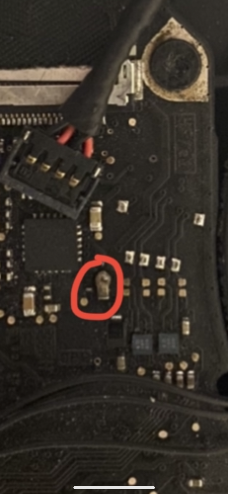

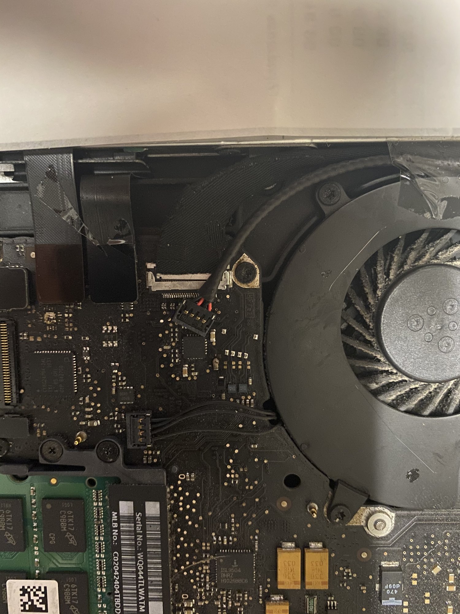

What ate me up was a blown speaker. While installing a new one I failed to disconnect the battery. Didn’t realize while trying to pry the speaker connector & accidentally shorted a tiny fuse of some sort next to it. Also broke off the whole connector. I’m not completely illiterate but I know it’s too small for me to replace myself. I will add a pic of what I think my shortage is. Could there be something bigger than this I don’t see?
Worst case, my board is fried, can I just replace it? If so where can I buy one? Worth taking to Genius Bar? Kind of ashamed. 🤦🏻‍♂️

Your MacBook is considered vintage which means the Apple store won't run any diagnostics or perform repairs.
I suggest finding a cheap parts machine with a working logic board or replace it with a newer model.

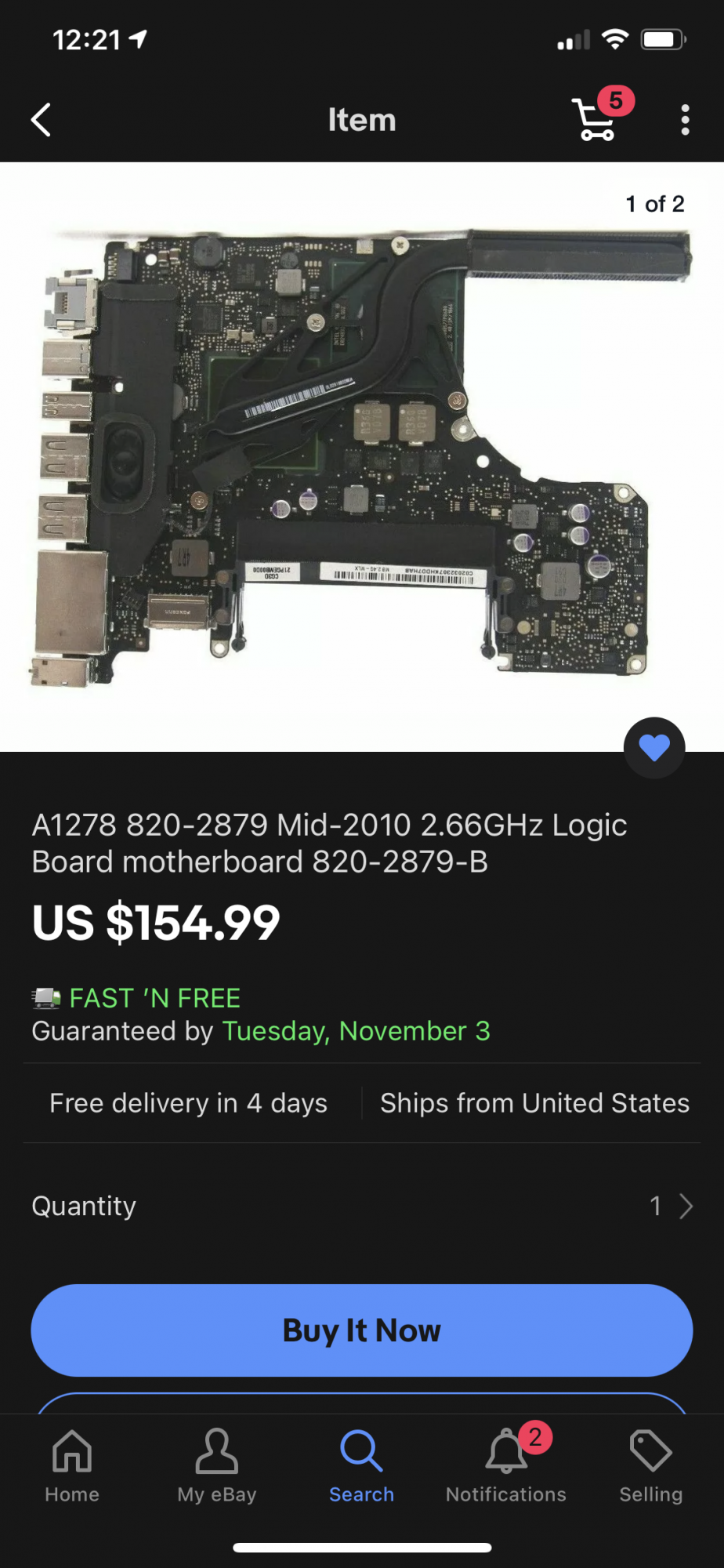

You could check eBay to see if there are any logic boards available there. I bought a fully upgraded logic board for my 2010 MacBook Air at the beginning of 2020, and that ran me about $55. Used iFixIt videos to guide me in replacing the board.

Thank you all for your suggestions. I will try & find a board to replace. If I can’t then another older Mac will have to do.

A replacement board will run you ~$500. Turn your loss into opportunity. For $300-$400 you can shop around for a mid-2012 machine that you can plop your drives into, plus bump to 16GB RAM

I found a drive for around 150. Wondering if that’s a decent price.
