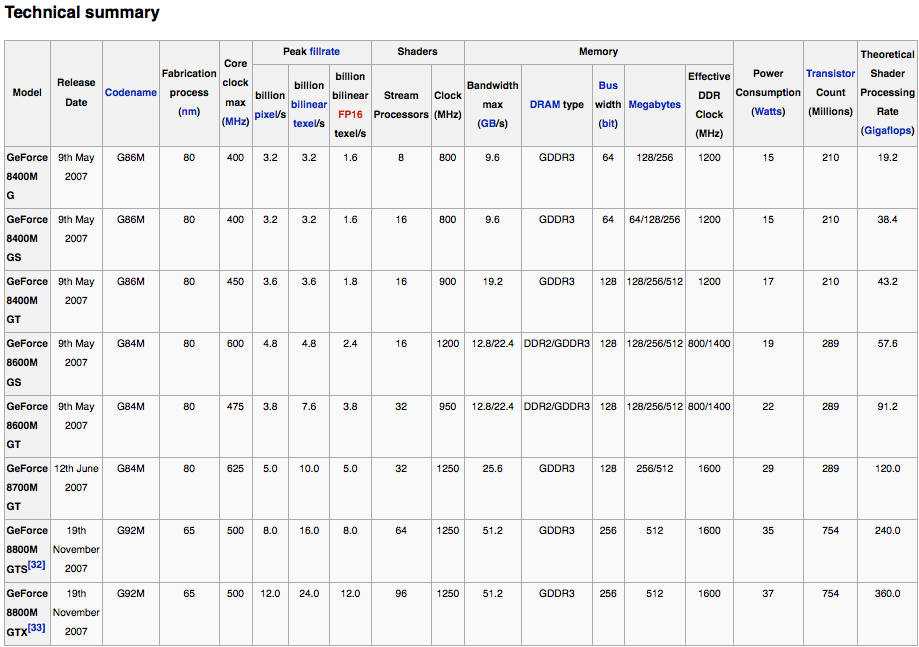

Source: http://en.wikipedia.org/wiki/GeForce_8_Series
Hmmm... I dunno how accurate this is...
