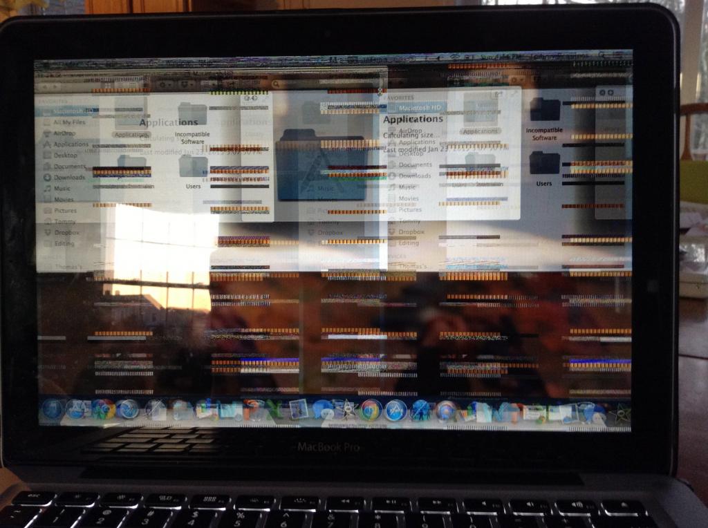

Hey all, I have a 2012 13" MBP (non-retina) and I've gotten this glitch a couple times over the 6 months I've had it.
2.5 ghz ivy bridge
16gb 1333mhz ram
Running 10.8.2

That is a dead (or dying) graphics chipset.

I've taken the following steps to narrow down the issue:
Tightened the monitor cable
Update to 10.10.1
Apple Hardware Test (Failed)
Wait, why would the hardware test fail? Black bars?
Okay I tried taking a stick of ram out from the top slot.
Still AHT failed.
So I took the bottom ram piece out and put in one stick to top slot.
AHT passed.
Bottom ram slot is dead.
