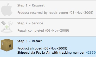

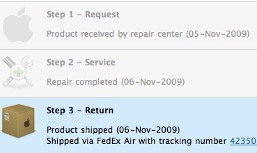

Happy Update
Well I think the saga has ended...and its been a positive turnout!
I called AppleCare after I took my computer to check to see if the test would show its my video card, and they said no, although there is a problem with the video card (didn't say what it was). I told the person on the phone that I would like to send it in for an Apple Depot $330 flat rate repair and after a few minutes he said ok and they overnighted a box.
I removed the label to return it and to my surprise my the estimate said $0 dollars because of the NVIDIA issue. I didn't think anything of it and sent it away the next day expecting to get a phone call given me an estimate in a couple days.
Well this morning I was pleasantly woke up by the fedex man with my computer box. I gladly signed and opened my computer to find their product repair summary:
"We replaced these parts:
Item Number: Description: Symptom:
605-1790 Logic Board Kernal Freeze
And even more surprised to read this:
"There is no charge for the service that we performed. Your repair is covered under the Quality Program service"
So I went from a $1200 estimate, to a $330 flat rate, to a free repair - I obviously couldn't be happier. Thanks to everyone for their help - thanks to apple for their customer service (and very fast repair!)
