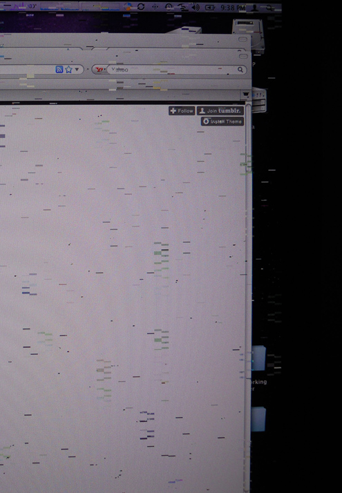

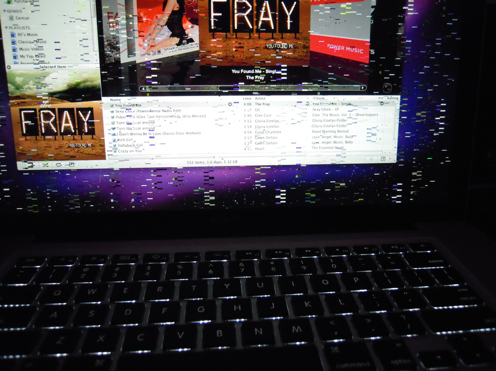

Tonight, I was just browsing the web and both screens locked up and the artifacts showed up. I could still see the windows and programs that were up, and the mouse would move and beach ball, but i couldn't click on anything. I left it for a couple minutes to see if it would recover, but it didnt. I grabbed a couple shots with my camera and i will post them tomorrow.
I'm wondering if this might indicate bad video memory for the nvidia chip??
Here are two shots of what happened to mine the other night... notice the artifacts. At this point the cursor moved, but I couldn't click anything. This is also what happens when it comes out of sleep mode once and a while. Any ideas??
