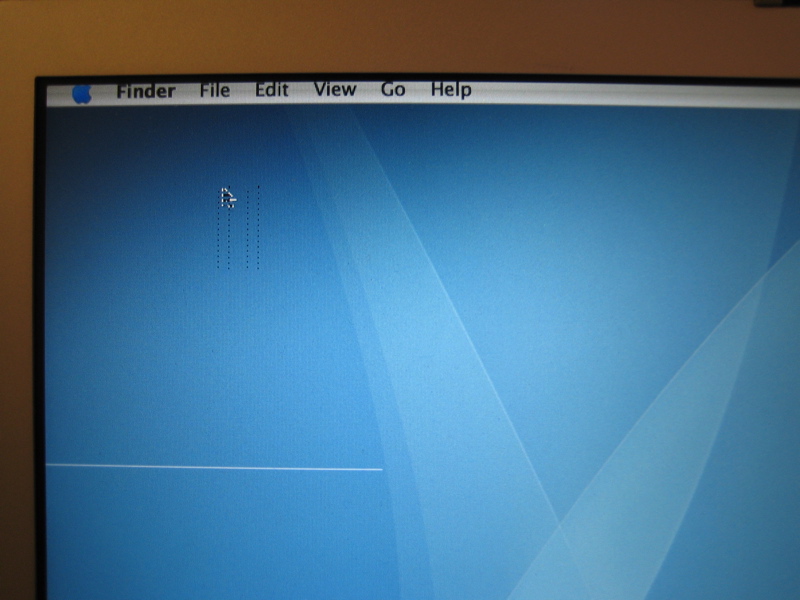

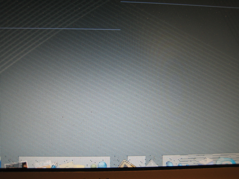

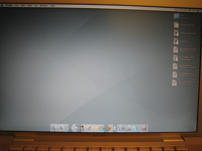

I have a 1.83 MBP, with 1.5 gigs of RAM (stock 512 + additional crucial 1gb) 80 gig HD. Pretty standard.
My issue is that once in a while when I restart my machine, bootup is really slow and then I get a weird screen glitch. Often I won't get a full re-boot but will get a half appearing dock and no desktop icons. Sometimes it will have lots of grainy lines across it. Sometimes I will get the beach ball for extended times and it will just freeze there. Basically I keep restarting it, and eventually it goes away and boots up normal.
The thing is I can't really replicate the problem. It just happens at random. Sometimes it happens after I have a system crash, and I need to restart, and sometimes it happens just after a system update restart.
Like I said, it doesn't happen that often, but when it does it kind of freaks me out. I've had the logic board replaced in the past to eliminate the "whinning" (which, thankfully is now gone) and I wonder if this is another logic board problem. Other than that the computer has been great. And upon the complementary Applecare expiring pretty soon, I wonder if I should take it in for a repair or just not worry about it. It's kind of hard to take it in if I can't really show them the problem.
Any thoughts, comments, suggestions, or ideas?

I would say it was GPU due to the screen glitching but that wouldn't explain slow boot times. I'd suggest that it's a logic board problem and you should go to an Apple Store and keep rebooting to see if you can get the glitch to appear.
It's not a foolproof plan but I'd give it a go.
if you can, you could try posting this on the apple support forums (Geniuses discredit any non-official apple forum, even this one) and link to the pictures.
Looks like a GPU issue to me, almost 100% certain. Take your machine back to Apple, they should be able to repair/replace it for you =]

So I took the MBP into an Apple Store today. The Genius deduced that since there are a bunch of weird lines around my cursor (*see pic #2) and they follow the cursor when it moves that it is a logic board issue.
He said he was certain that it wasn't a GPU issue. As I mentioned earlier I have already had my logic board fixed once before, to remove the whine. I hope when it comes back it'll be all good and fixed, with no whine. One can hope...
He mentioned that it could possibly have been a loose screen connector 'causing the problem, but then figured, no, it's probably not.
So the part is on order. Let's hope it works out. I'm banking on getting this fixed and then living with whatever else happens, since I can't afford to get Applecare right now. This is the lats month of complementary support.
