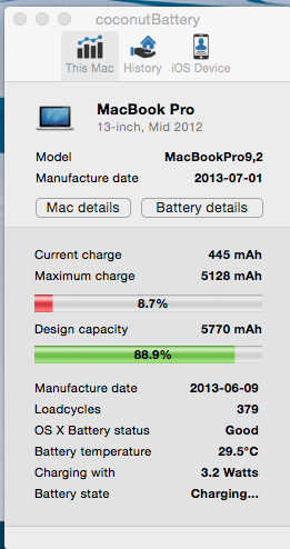

Thanks, here is a screen shot. Just a FYI, the MBP started to charge, it is now up to 9%. The charger was staying green, now it's orange.

Hey Sandman, first you were right to try and reset the SMC as it is what controls the battery charging circuit. What you may need to do is open her up and do some initial checks on the power rails associated with the SMC "5" SMBus Connections.What you have is two pullup resistors that can be associated with sending the wrong information to the battery charger or vice versa to the SMC. I can go into more detail if you like, but in any case this is where you might want to start.
