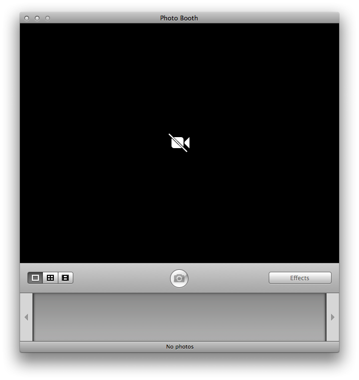

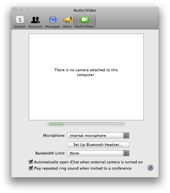

Right, whenever I start Photobooth or iChat, it shows up the no camera icon or it says that the camera isn't attached.
What went wrong?

It could be. People will keep posting telling you to reset things, but it probably is something to do with hardware. The USB connector is probably loose or disconnected.
It's a built in iSight. Not the USB one.
I'll try to go to the Apple Store then, and see what they say.

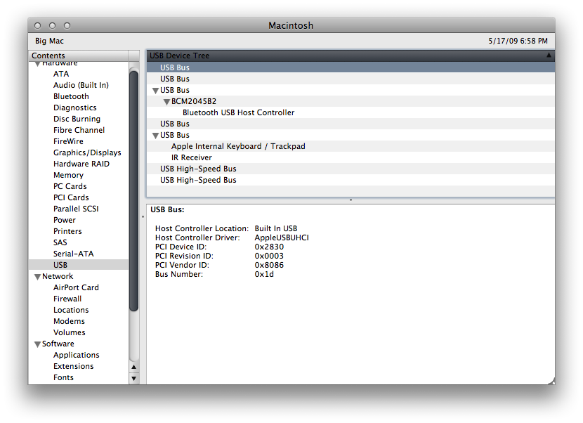

Even though it's built-in, it's still connected through USB. Just open System Profiler. If the iSight is recognized, it will show up in the USB device tree.

Okay. Well this is what shows up in my USB tree. Which one of them is the iSight?

The iSight isn't listed, so if an smc reset didn't work (make sure you did it correctly) then it is a hardware issue such as a loose or faulty cable. Take it to an apple store or call applecare to resolve the issue
and btw, when it is listed it has the name iSight in it, so you'll be able to tell which one it is clearly
Like everyone else is saying, it would be the one named iSight. Since you have no iSight entry in the list, it's broken. Take it to the Apple Store for a fix.

If the iSight has malfunctioned, they will be replacing the entire top lid, including the display.
And as others mentioned, it certainly seems like a hardware fault.
