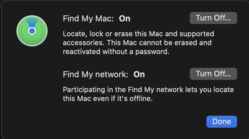

How about turning off "Find my MAC"? Just to see if that will stop this intermittent glitch with Bluetooth devices. It hasn't been mentioned above as a potential fix to try, and may at least point the way for a proper long term fix from Apple.
Looking at the options on "Find my Mac" - they look like full remote access is possible, even if the Mac has its WIFI and BLUETOOTH connectivity all turn't off. Gosh, really?!

In my opinion, turning off the Find My network on the MacBook will not help. As far as I understand the concept, that setting controls if your Mac tries to connect to other Apple devices in the vicinity. It is all the Apple devices around you that need the Find My network disabled--I don't think we have control over participating in Find My network. Which of course raises the question, if I consented to allow everyone with an Apple device around me to try to connect to my iPhone for instance, generating internet traffic, which could be from my limited mobile internet plan.
But yes, I thought of that, and just disabled Find My network on my iPhone, that is usually in my pocket, and I am obviously in arms reach from my MacBook. So far I didn't see any mysterious bluetooth devices popping up in the Bluetooth Settings list.
However, this cannot be the solution. I would have to ask all the people to turn their Find My network off next time I want to use my MacBook while enjoying a coffee in a coffee shop. Not to mention, how can Apple expect me to turn a security feature off on my iPhone, just so that it wouldn't have problem with my MacBook!?

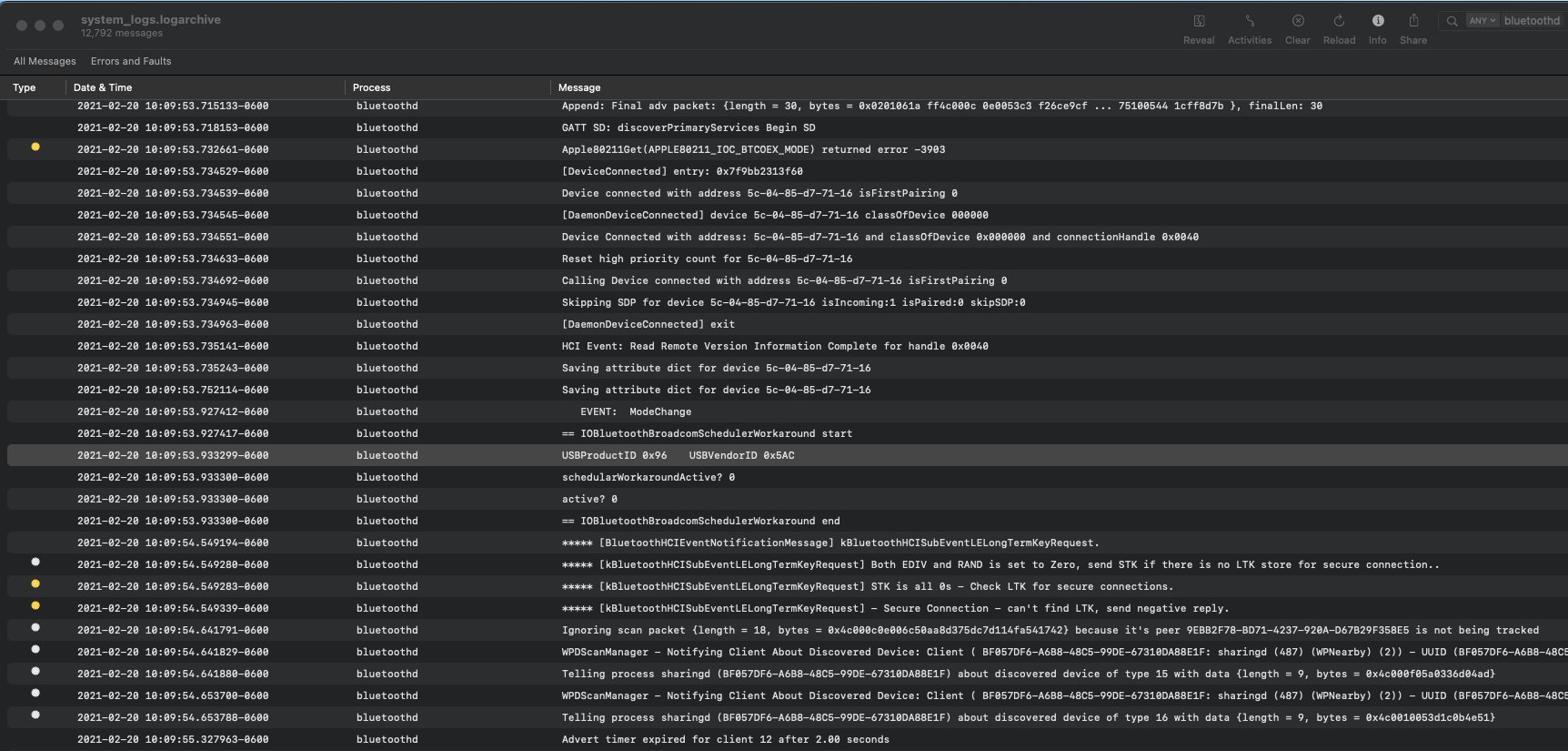

I managed to record that incident.
This is when the mysterious device appears, and the mouse becomes unresponsive.
This is when the mouse reconnects.
(Please, note the time stamps, the incident took a little less than a minute)
I saved the system logs too. I am new to MacOS, so I am not sure if I am interpreting the messages correctly, but the bluetoothd shows a line with a USB vendor ID, right around my mouse became unresponsive.
That vendor ID (0x5AC) is Apple, if I'm not mistaken. And of course, I am not sure if it's at all relevant, after all it's about a USB vendor ID, but reported by bluetoothd.

The language isn't all that clear, but the on/off message says "participating in..." so it certainly makes it sound like disabling that option will both stop your device from sending its location to other devices AND stop it from receiving incoming connections from other devices. I couldn't find any documentation explicitly confirming that, though.
In any case, I tried turning it off on both phones and the Mac in question, and it did not seem to help much if at all. The only possible "foreign" devices that could be in bluetooth range would be one neighbor's house, so if indeed it will still accept incoming connections even with it disabled it's hypothetically possible that's the source.

I really appreciate you recording it; your videos look identical to when it happens to me, so it's great to have a reference for "this is what it looks like".
Yes, that's the same vendor ID I got, and I confirmed that it's Apple. The address string is of course meaningless, since Apple devices randomize that for security/privacy reasons.

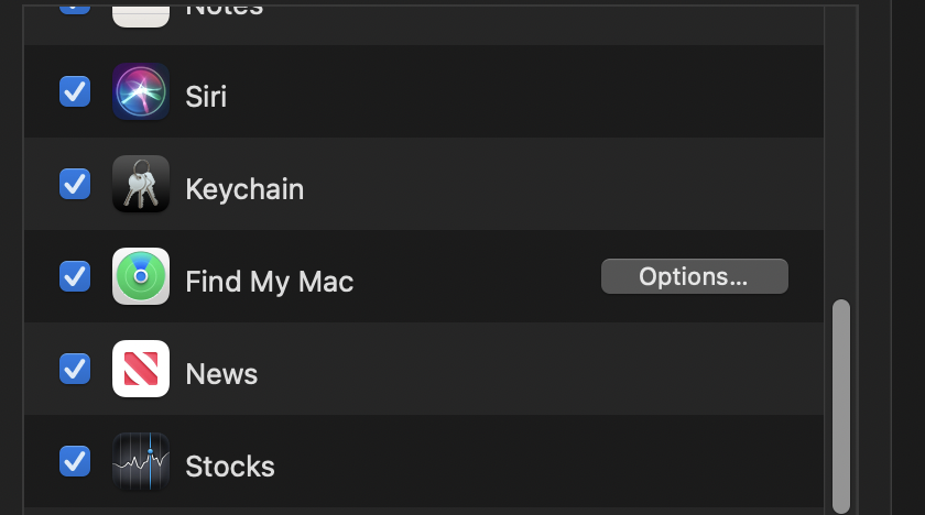

I've double read the posts above, and the only thing stated as tried is: Turn't off the "Find my network".
How you tried fully turning off "Find my Mac"? I.e. Unticking the box below?
As I say, I've double read the posts above and the only thing confirmed as tried is turn't off the "Find my network." I presume this means in the "Options" against "Find my Mac". As shown in screenshot below:
Fully turning off the "Find my Mac" in the parent screen would not be a permanent fix, but it would at least be something to try. Hope that helps, and hope you get it sorted.
Best wishes
Martin
OK, let's try that, then. I turned Find My Mac off. Stand by for test results.

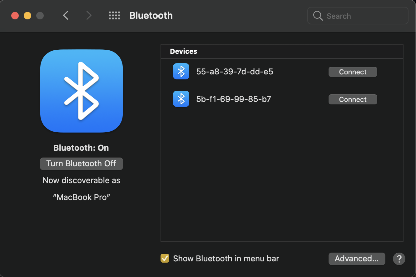

I just tested an idea. I turned off all BT mice, and was looking at the device list in BT settings. Nothing popped up. Just for good measure, I turned on a few random BT devices, and they showed up as expected, with their proper names. But not the mysterious ones I was expecting. So, it seems the mouse indeed plays a role in what's happening. And everything else seems to be just find in the house.

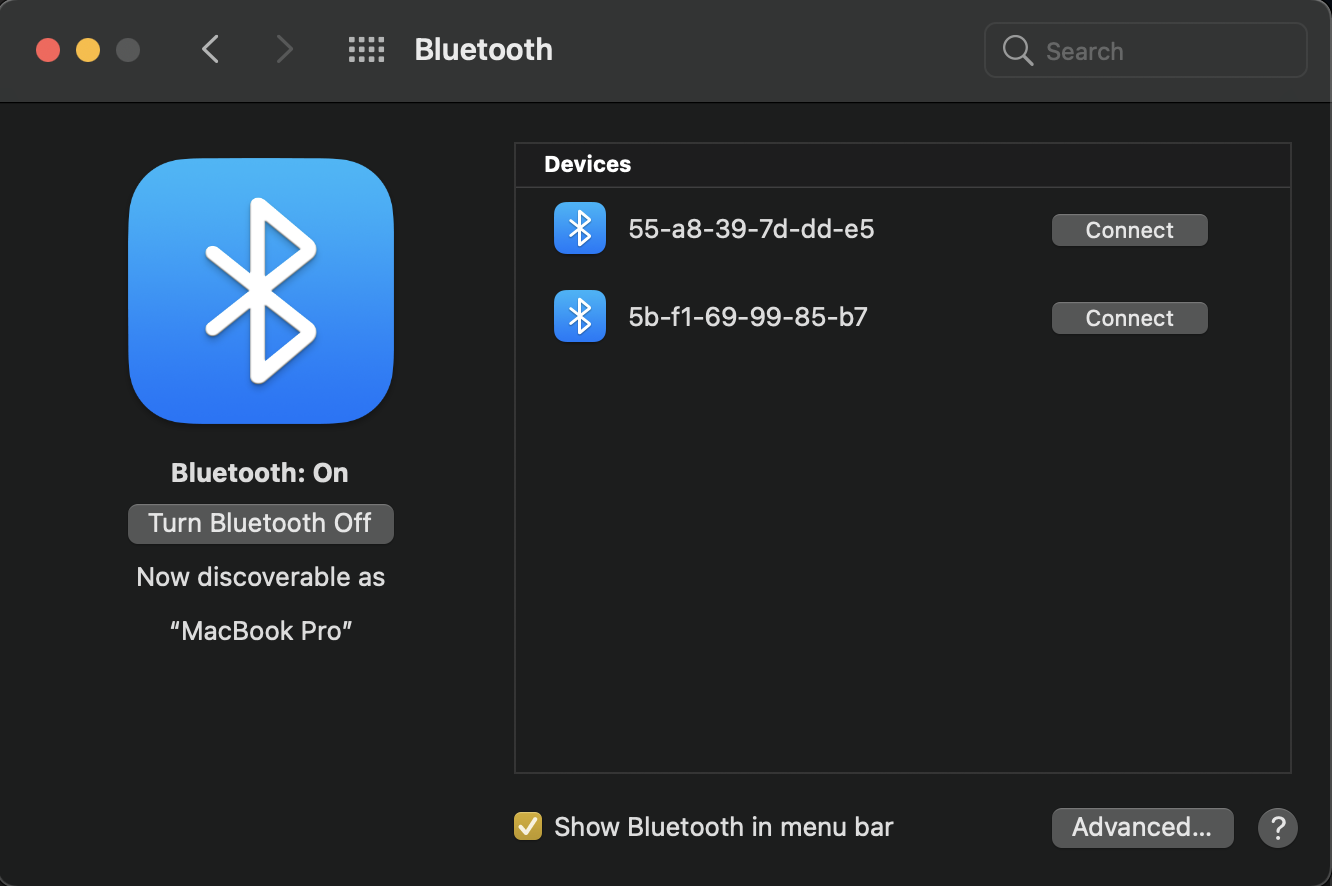

The moment I pressed "Post reply", a "mysterious" device appeared in the device list in BT settings. 🙂 So, it is indeed something around me trying to connect, independent from any mouse.

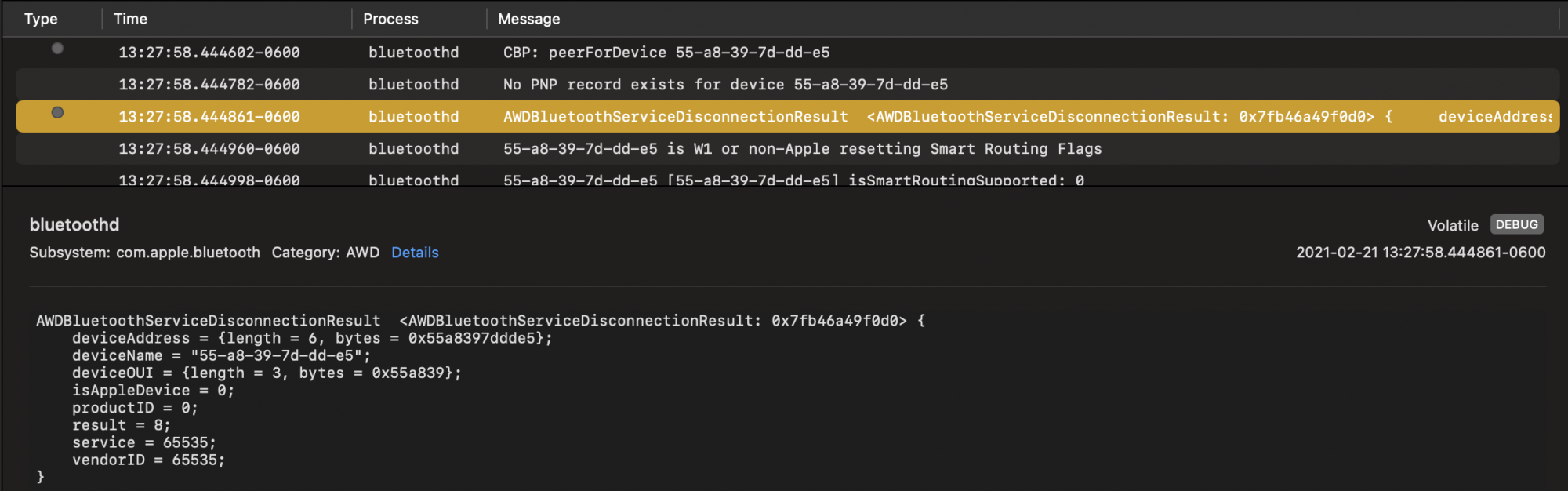

Although in an earlier post I was showing that "USB" message with an Apple vendor ID, I found something else.
Yes, a few mysterious devices popped up while no mouse (or no BT device for that matter) was connected.

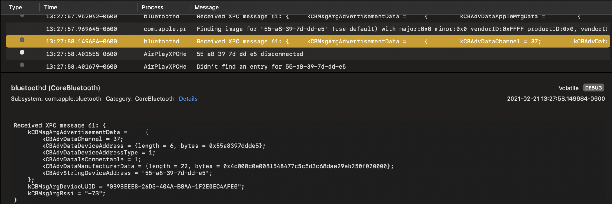

I had the console on, and saw a few interesting messages related to that address.
And a little later.
That second message I am showing above says "isAppleDevice = 0".
There's only one BT device around me to my knowledge that is not turned off. My Garmin watch. Could that be the culprit? @Makosuke, don't you by chance have a Garmin Fenix smart watch on your arm?
