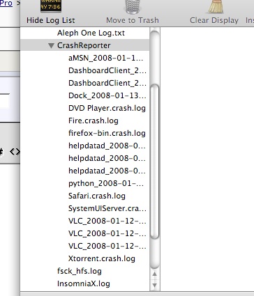

Well I get this list.....Here I attached a pic of it.

Look at crashreporter under var/log?
Ths is odd my crashreporter log has the last entry as dec 29th, even though I had just crashed prior to posting this topic.....
