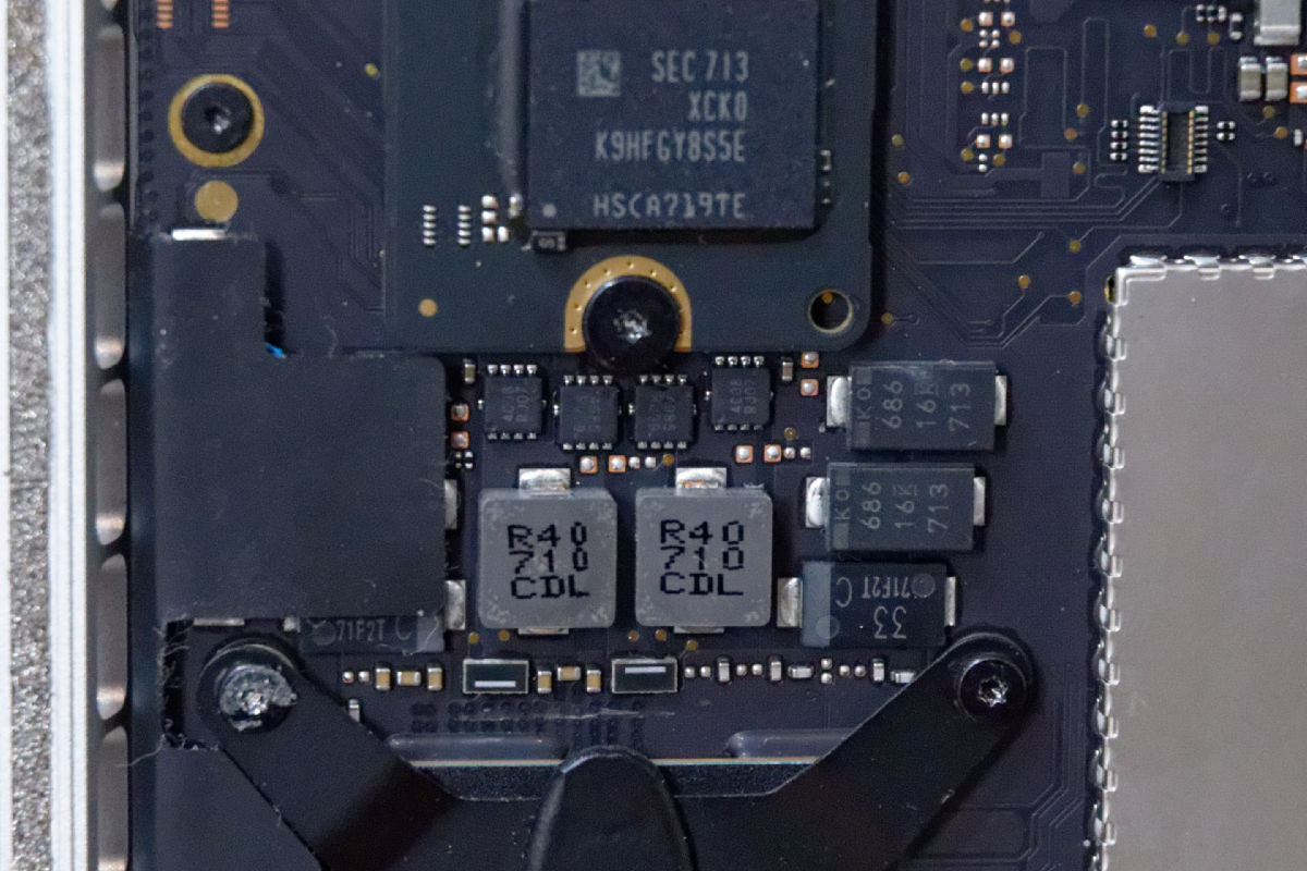

Does someone got some information about the Power Issues on a MBP Late 2013-2014?
I only found this: http://knownappleissues.com/2020/01/07/2013-2015-13-15-macbook-pro-power-issues/
The only information given to fix it, is to replace the VRM. But i did not found any other information about this. I planned to get a late 2013 or mid 2014 for testing this out for my Blog https://www.die-oswalds.de/blog/

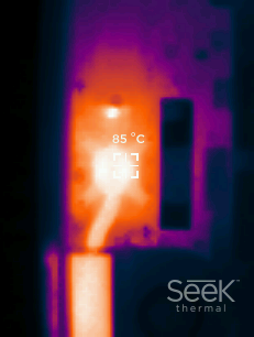

But i noticed it just turns off. CPU was around 100°C and another component also went over 100°c But this only happened once. Other times the machine turned off without a very high temperature.
One of the chip beneath the SSD went over 100°C, I suppose the second from the left.
