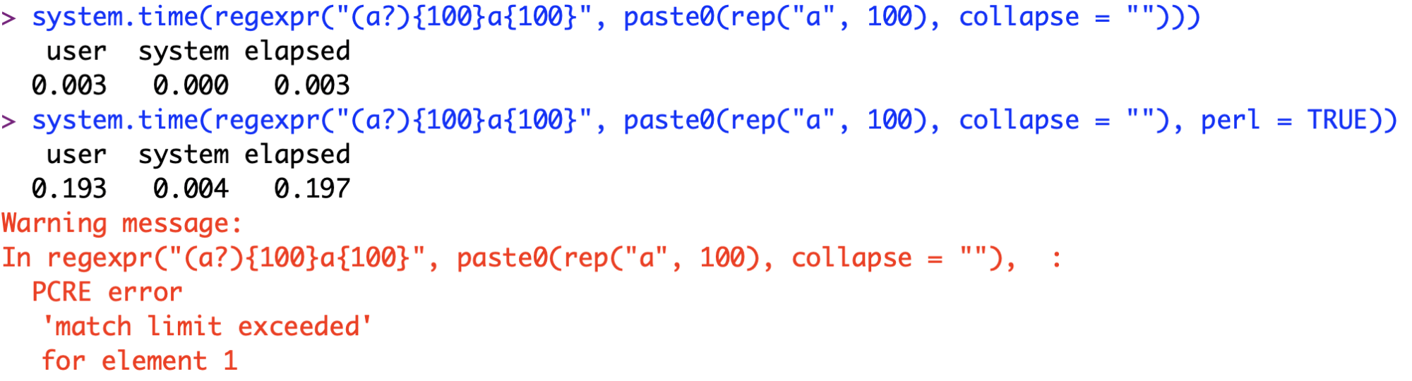

FWIW, matching the regex for the sequence of length 100 using R regex takes under 3ms. If I try to use the PCRE backend it crashes with a "match limit exceeded" warning. I think you are just running into a pathological case with the perl regex engine.

PCRE is fairly well optimised for ARM, including a regex JIT compiler that makes uses of ARM Neon. That is hardly the problem here. This is a pathological regex on pathological data, the only thing it shows here is that PCRE has a problem with this case.
Well, I just posted evidence that the M1 doesn't always run circles around the i9. PCRE or PCRE2 obviously isn't the Perl regex engine.
PCRE aborts backtracking after a (probably hardcoded) maximum number of steps. The Perl regex engine doesn't have that limit.

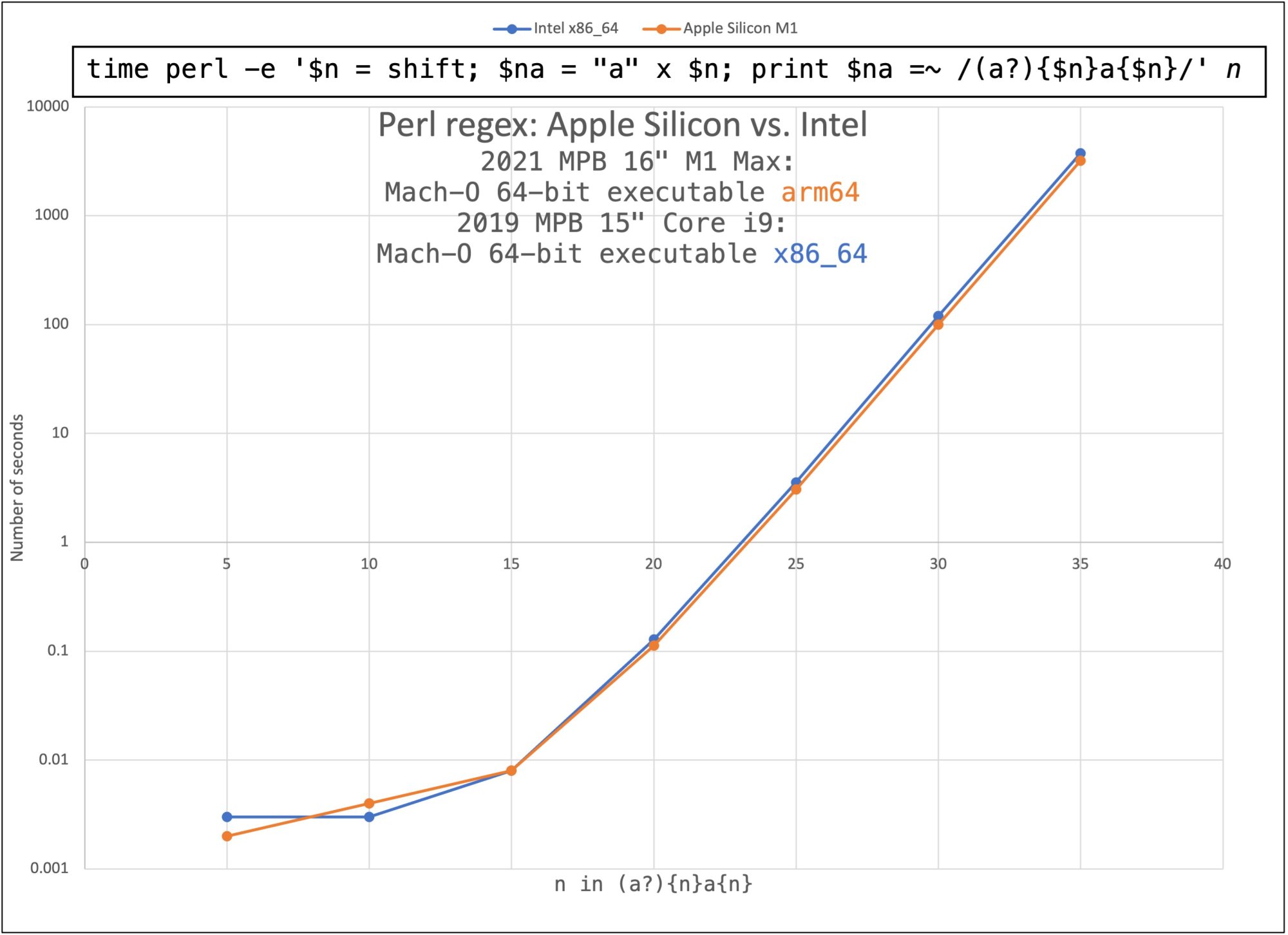

Other people have been able to replicate it. Let me provide a brief tutorial. In Terminal, type
which perl
you should have some version of Perl on any Mac.
Then use exactly my one-liner, e.g.:
time perl -e '$n = shift; $na = "a" x $n; print $na =~ /(a?){$n}a{$n}/' 25
There you go.

Thanks, was able to replicate it now. I also modified the script to consistently produce output to make sure it actually works (for some reason print doesn't print anything on my machine, you have to save the result to a variable and print that variable for the result to appear).
Anyway, my statement still stands. You are running into some algorithmic scalability issue with the perl regex matcher on this particular pathological regex. One would need to profile the code to understand what's going on. Is is indeed puzzling that the results are practically identical for both machines, which leads me to suspect that there is some sort of external bottleneck (maybe memory allocation for backtracking, no idea, I don't know how perl's regex engine is implemented).
Reactions: Basic75
Anyway, my statement still stands. ... Is is indeed puzzling that the results are practically identical for both machines, which leads me to suspect that there is some sort of external bottleneck (maybe memory allocation for backtracking, no idea, I don't know how perl's regex engine is implemented).
Yes. save the value and print. But it works whether the print does anything or not.
The whole point of the exercise is to deliberately force the worst case backtracking for the non-deterministic regex engine.
The puzzling fact that I thought I was pointing out is that they're indeed nearly identical!

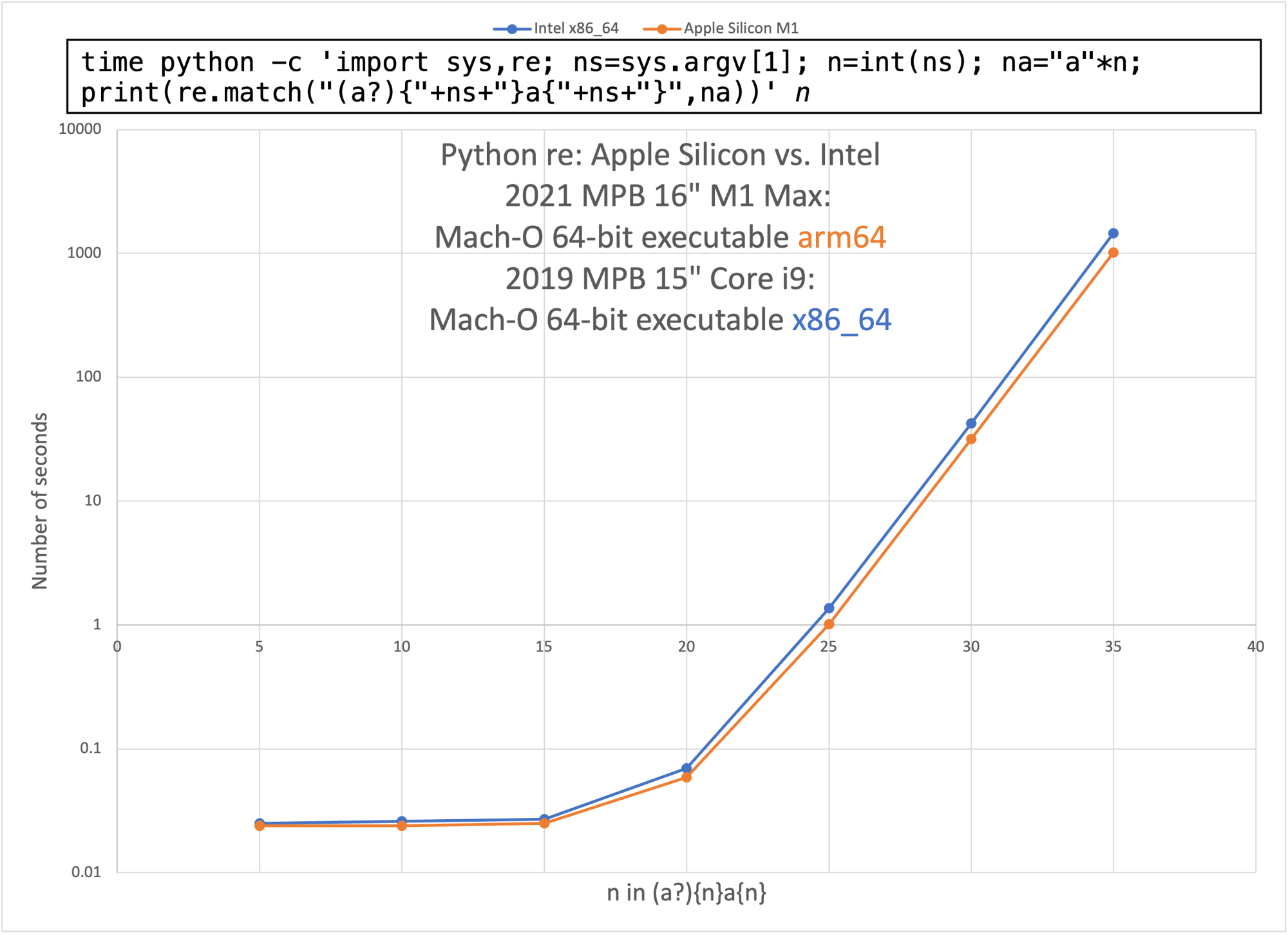

Well, it's not just Perl. Let's look at the same regex matching using Python. Again, I give a one-liner that anyone can run from the Terminal. There is a small gap, but again the M1 Max isn't much different from a 4 year-old 2018 Intel Core i9 (i9-8950HK).

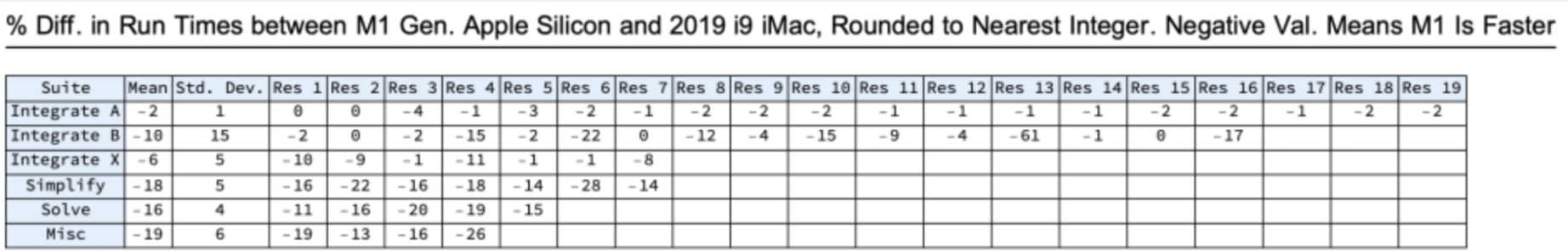

Here's another comparison of Coffee Lake with M1 (specifically an M1 Max Mac Studio vs. a 2019 i9 iMac) for scientific computing. Here I tested a variety of single-threaded symbolic computation tasks in Mathematica, and found a wide range of differences in performance. For instance, look at the first two rows, which show the results for 35 different symbolic integrations. The M1 averages about 5% faster, with individual differences ranging from 0% to 61%.
There's at least three take-home messages:
1) Obviously, you want to look at a variety of tasks.
2) Performance deltas can vary widely even within the same class of task (e.g., symbolic integration). In these tests, integrations that had about the same run time on the M1 and iMac usually (but not always) were those whose solutions had lots of terms (100's to 1000's) (though this wasn't because of the time it took to display the solutions, since the outputs were suppressed).
2) It's not uncommon to find tasks that show no significant performance difference between the M1 and a late-model Intel Mac.
