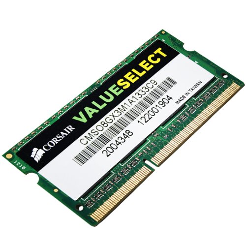

I have 16GB 1333MHz on my 2010 Mini (actually, the modules were SPD-reassigned to 1066MHz by using a Windows app, so the firmware recognizes them as lower speed modules). The modules are these ones:
