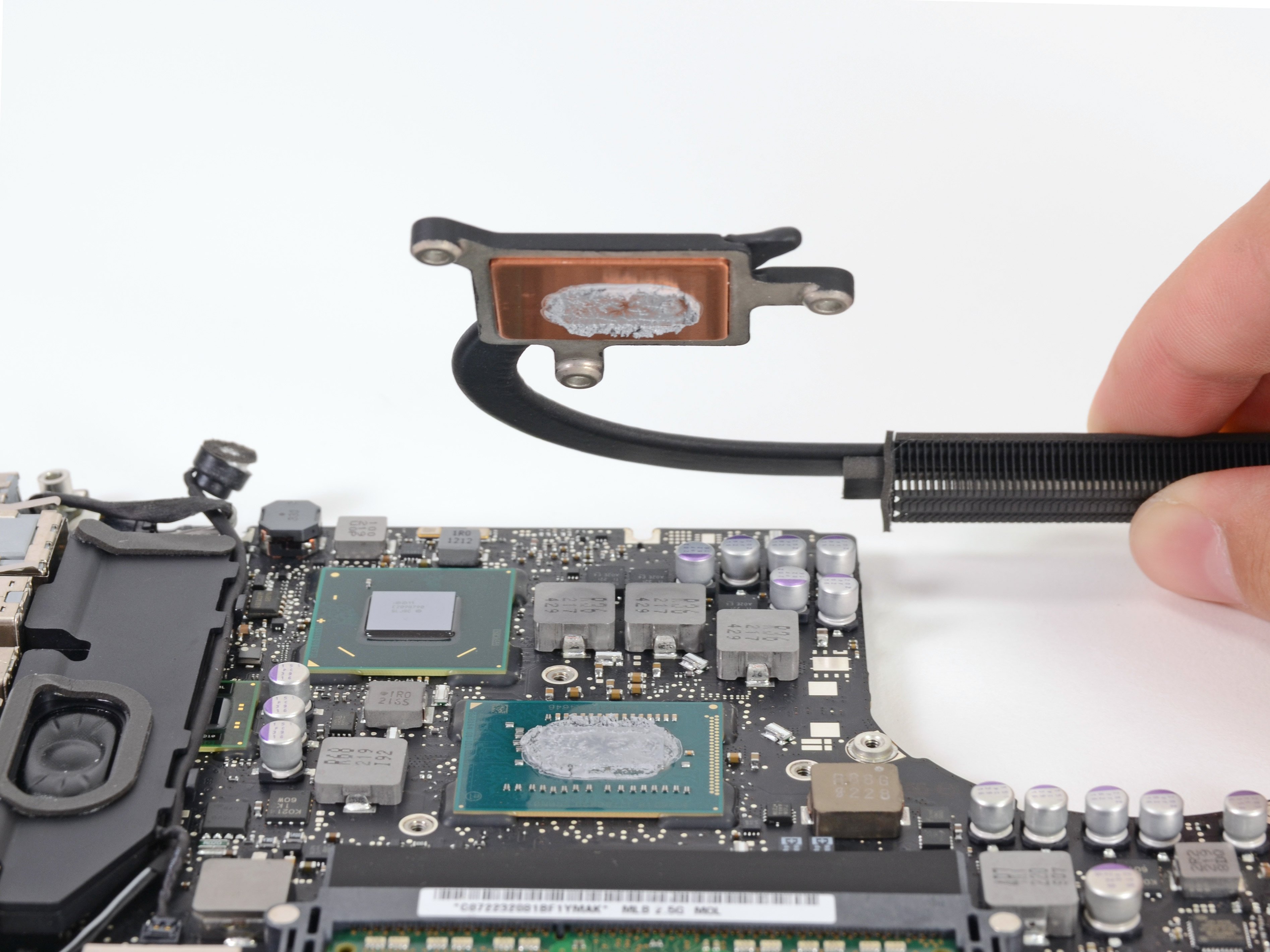

First of all I would open it and dedust it .
When you remove the fan (3 screws) you'll probably see a lot of dust cloacked in the heatsink/around the fan.
The fan cable is fragile , so be careful .
Even better would be to repaste the CPU and GPU (about 10 years old and very likely never done), but should be done by an experienced person /professional.
E.g. ifixit has tutorials about disassembling/repaste etc
TG Pro or MacsFanControl can be very useful to keep the MBP a bit cooler.

I hope you're comfortable with disassembling lots of parts .
You could also just clean the fan and the heatsink in front of the fan to stay on the safe side.
There are lots of parts and connectors to be careful with....
Here's an ifixit tutorial to get an idea , note that it says : level difficult!!!

I think you made a wise decision, I'm experienced in this field and did a repaste on this exact model too, and can confirm that you have to be very careful (especially with all connectors and the direction in which they're inserted etc.).

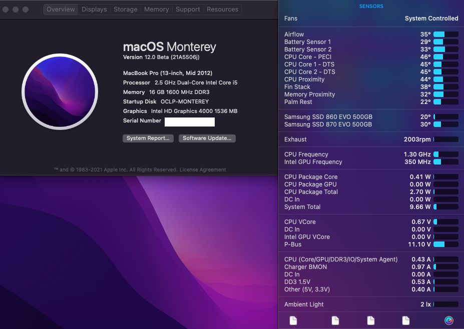

after Arctic MX-5 paste used, just make sure ground yourself before removing parts.
