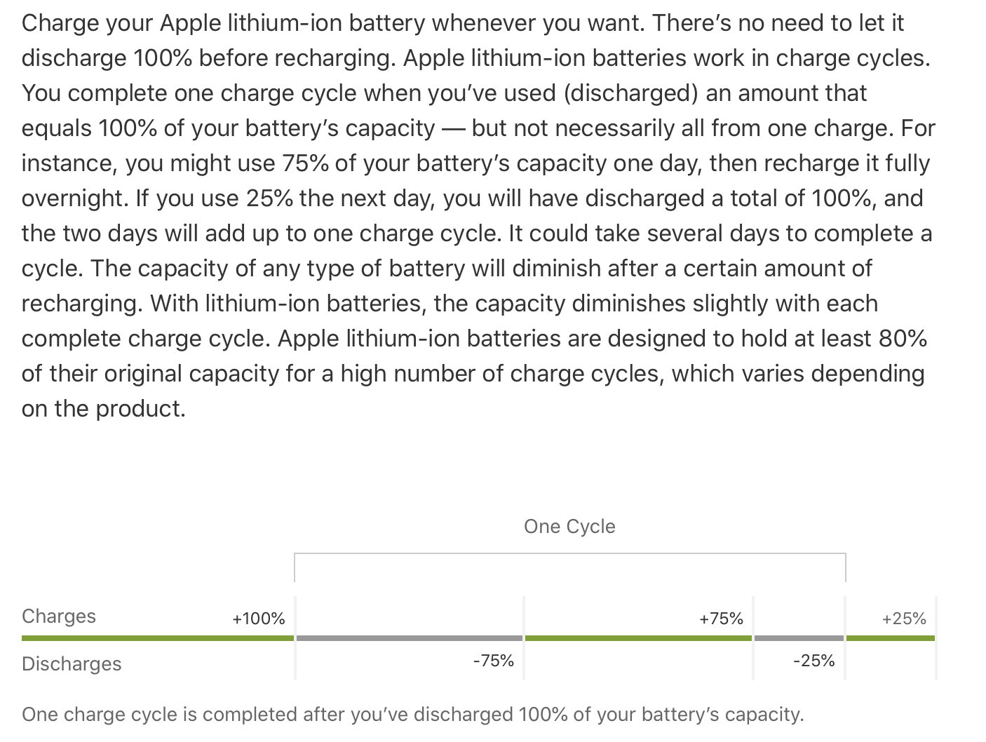

I actually need to Google what is classified as a 'battery cycle'...
The number of charge cycles, at least how Apple interprets it, is the total aggregate percentages discharged. So discharging 75% one day (and recharging), then discharging 25% the next day (and recharging) counts as one charge cycle.
The fact that one discharge of 100% is more damaging that two discharges of 50% is ignored; both are counted as one charge cycle.
