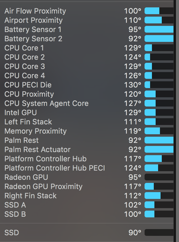

Hey,
I recently purchased a 2015 Mid 15" MacbookPro with full spec on it with the 2GB GFX, 512GB SSD, 16gb ram and the 2.5Ghz processor
It is a second-hand laptop with around 300+ cycles with its battery
The problem that I face is that the temperature gets high and it gets super hot quickly and with ISTAT, the temparatures on idle stay at around:
What should I do ? I was thinking about opening it up and cleaning it of dust or something.
I've had previously a 1 year old MBP 2015 with the lowest 13" model and I've never had these heat problems with it.
Let me know please!
Wait, are those in Celcius? If so (and I assume they are if you say it feels hot) that’s really bad! You’ll be suffering a lot of thermal throttling with those temps.
You should give it a clean as your highest priority and perhaps even minimise or cease use until then. You’ll be surprised how much crap will have accumulated if it’s about 3 years old. You’ll need to buy a Pentalobe screwdriver to get the bottom case off.
But with those temps I’m wondering if something else needs fixing like thermal paste or a broken fan. it might be worth getting it looked at.

Hey,
The thing is that it does not seem to slow down, but I was used to the power of the little 13" from before so yeah haha😀
Can you recommend me a kit for doing this? ( ifixit maybe ? ) and a thermal paste?

I am assuming those temps are in Fahrenheit unless you sit in an oven. 91 degrees C at the touchpad and your fingers would be medium to well done.
So assuming Fahrenheit these temps are a little high. I have the same model and idle (have not done anything in 5-10 minutes) temps for the CPU are in the 40-43C (105-115F) range.
If you are doing anything with heavy load, Machine Learning, gaming, etc. You can expect to see CPU temps close to 200 F. The CPU will start throttling a little higher and the fans will really be going in an attempt to keep the system from going over 212F (100C).
Remember your 15" has 4 cores and can dissipate 45 W of power, versus 28W for your 13" dual core. The 15" units do run a bit hotter, and when you load them up they run a lot hotter, and faster.
I would see if blowing out the fans and the heatsinks helps.
Used, with a 300+ cycle battery? My suspicion is the biggest source of heat might be that battery, because pretty much every heat sensor in there seems a bit high.
Doubt it's going to be fixed with re-paste, due to every sensor showing higher temps. Re-paste won't hurt, but it's probably not going to totally fix things.
You could also try cleaning out the fans, but I'd also probably look at getting a new battery if it were me.
Hey there guys,
They were Fahrenheit, indeed! Celsius the temp stays around 50degrees with chrome opened and other 2 programs but it gets hot as f**k when I plug in the 4K monitor ( don't have stats yet, did not test ).
I was thinking also to get the battery from ifixit and that toolkit to give it a good refresh and cleanup
