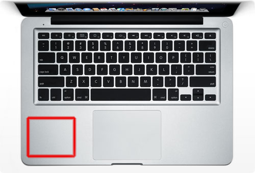

Hey guys.
I own a Mid 2010 13" MBP. (7.1 model).
I was working with it right now, and I took my iPhone to look some stuff up.
I then put the iPhone on the MBP right here (see attached image) and suddenly the screen went off. I assumed it was the computer saving battery.
Well, I then took my iPhone and put it into my pocket again, turned on the screen and continued working. I then took my iPhone again, put it onto the same place and the screen went off again!!!
Any explanation?

What the *****? Any explanation?
Sounds like interference.
After more testing it seems it puts it into sleep mode, not just screen off.
(Also the iPhone is inside a rubber case)
Interference can interfere your WiFi and make it work worse. It shouldn't put your computer into sleep mode...

I know that there are magnetic switches under there that sense when the screen is down, hence when you touch the palmrest with a smart cover, the display goes off.
Yeah, there are magnetic switches in the case which put it to sleep mode when you close. It's possible, if you have a very sensitive magnet, that the magnet in your iPhone's speaker is causing it to go into sleep mode.
http://en.m.wikipedia.org/wiki/Reed_switch
http://guide-images.ifixit.net/igi/SDP2g5nVO4f5I5C6.large
