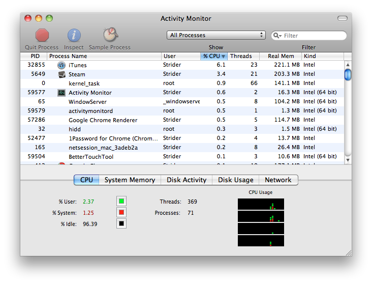

Whats listed within Activity Monitor? Screen shot 2011-02-01 at 19.47.54.png Look for the 64bit on the right hand side.
It is showing 64bit listed next to several applications. However, I thought that meant those apps could run in 64bit. When I check the 64 bit kernal to see if the machine is running in 64bit, I am still seeing this...
That means the apps are actually 64-bit and running 64-bit, as that does not require the 64-bit kernel
