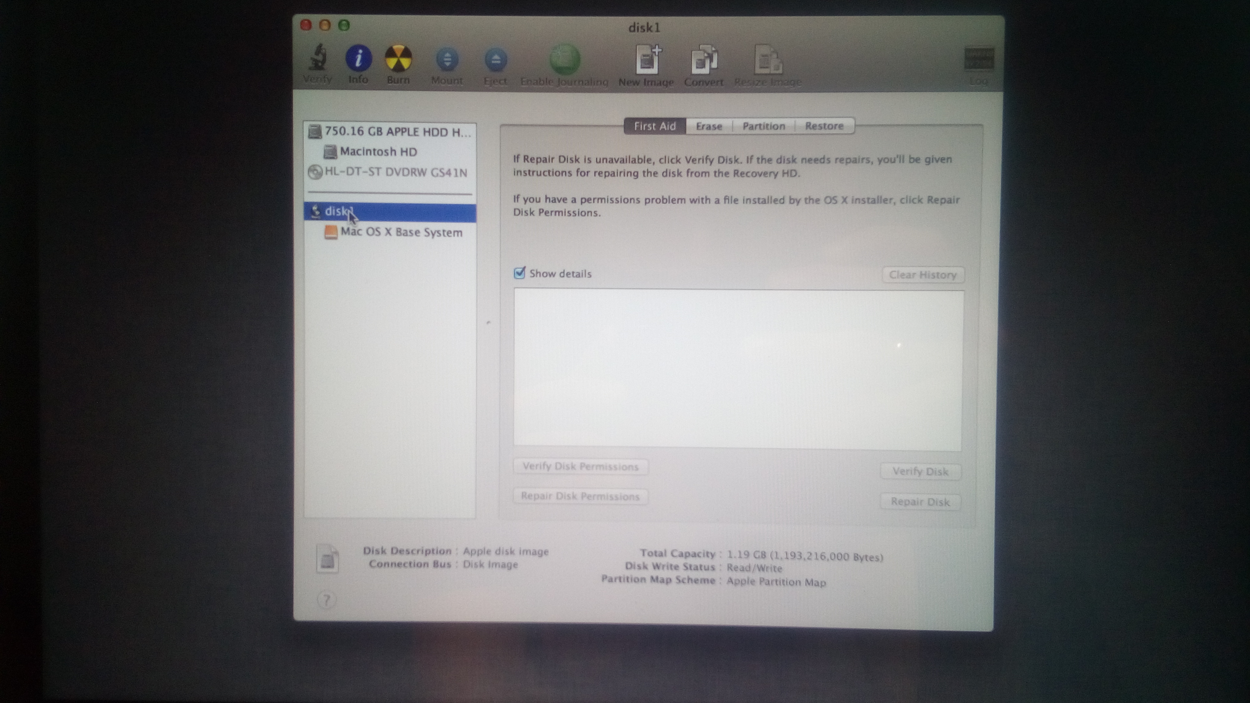

OK it finally booted and it's working smoothly! So I would guess the HDD isn't (fully?) dead, and maybe it was a software issue after all.

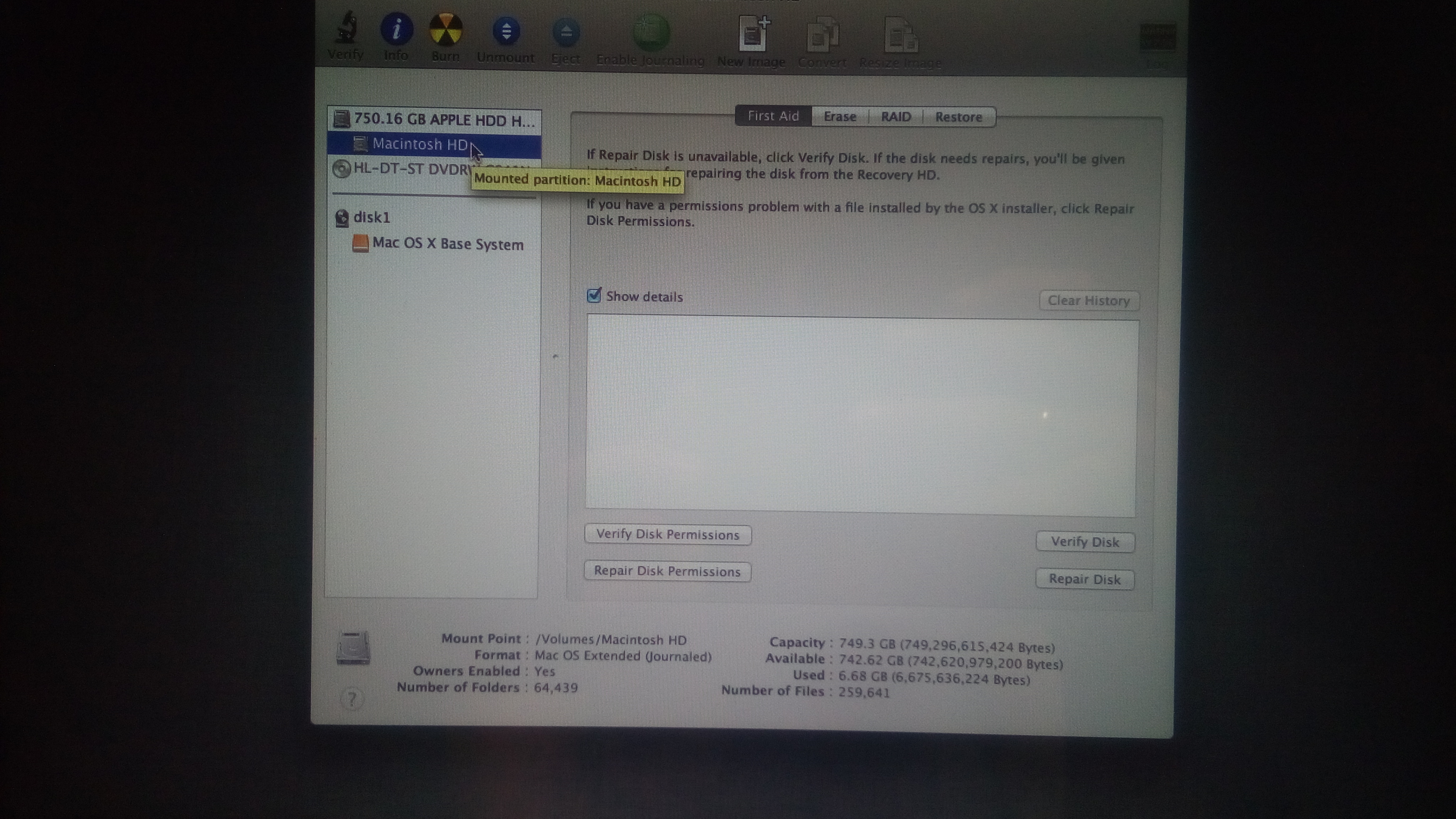

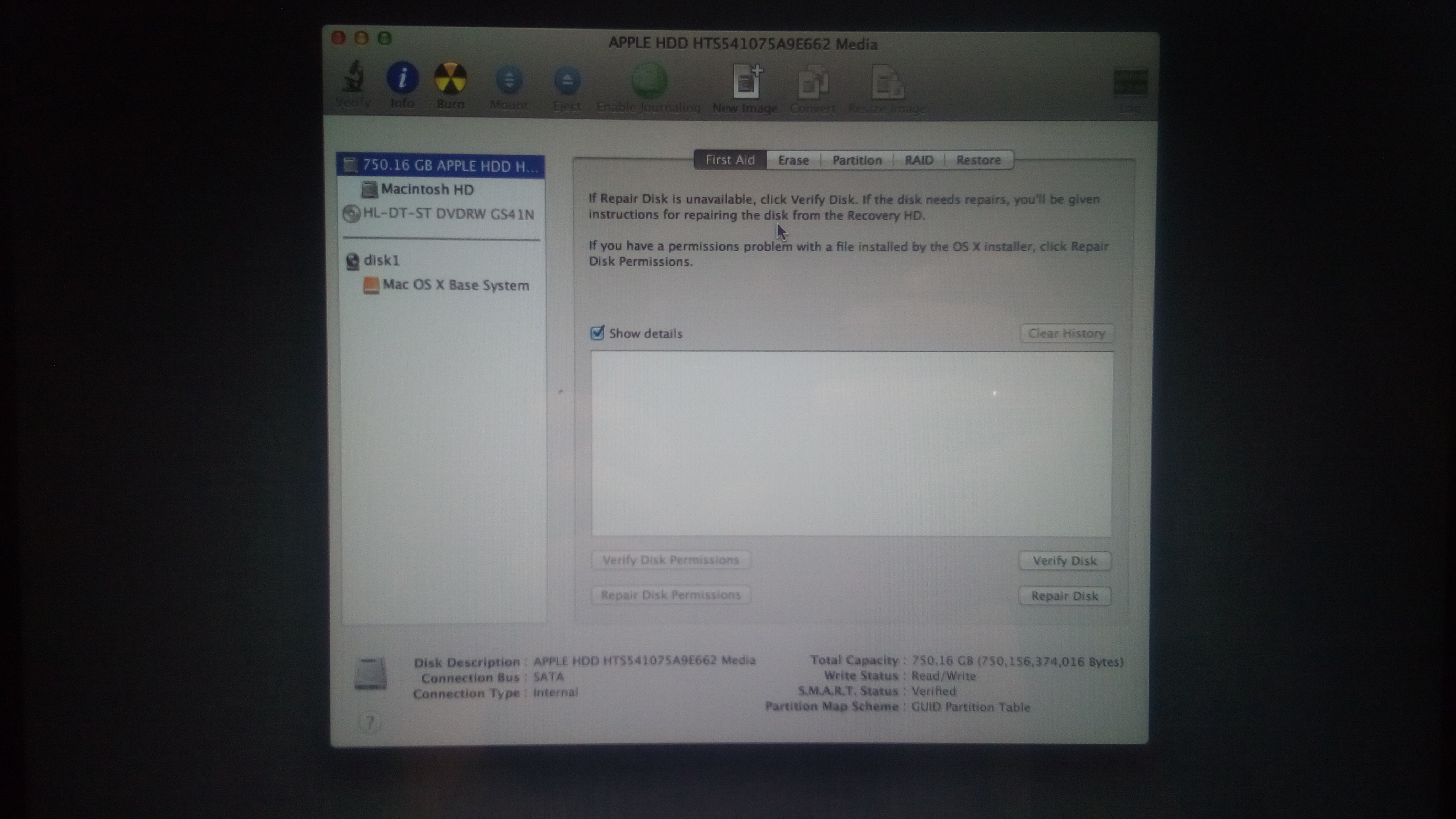

This is what was done:
When I started it up yesterday in recovery mode, I noticed that the upper HDD partition was fully erased after all (It wasn't like that right after the 'erase'), with 749GB available. So I tried to put a fresh install of OS X on that drive, and it fully continued.
After the install I tried a regular boot, didn't work as it still had the previous partition active as boot disk apparently, so again via recovery mode:
You can see there's now 6gb on it for the OS.
Images below show details on the other partition with the old OS. Via the recovery software I can't do anything with it, does it look OK in general?

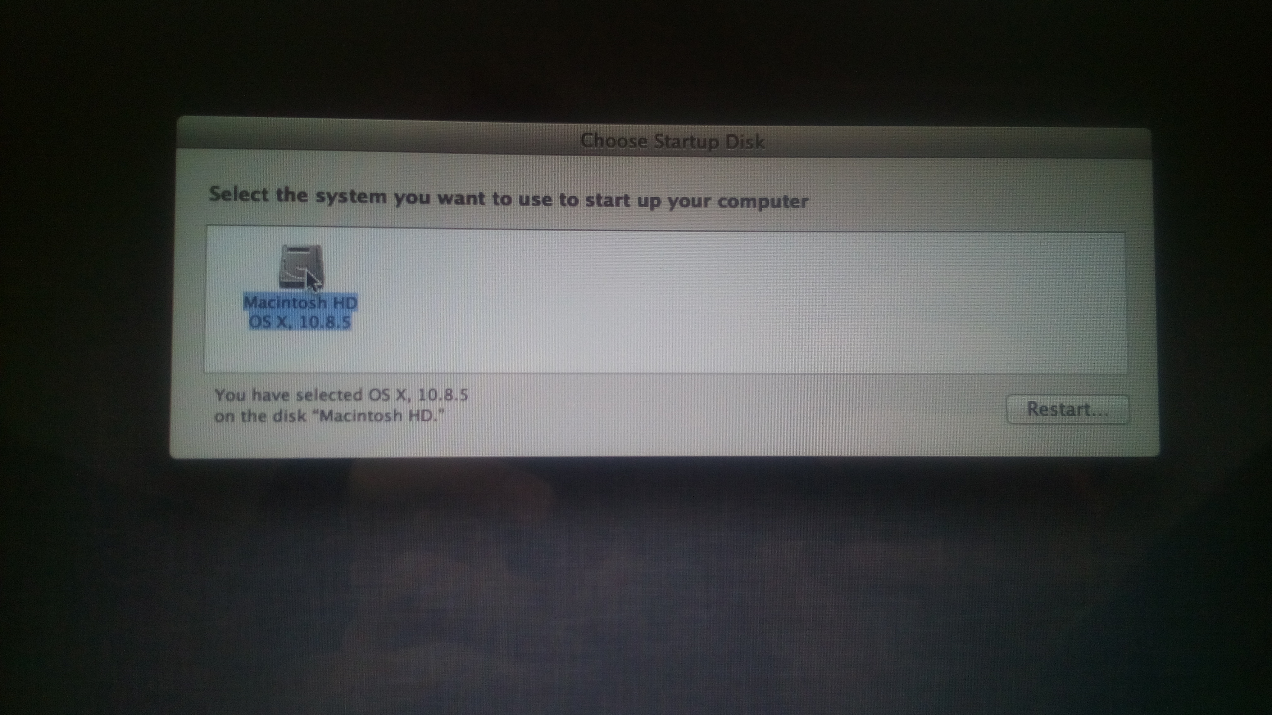

After checking the disks, I selected the other disk to use as boot disk:
And now I'm in! Running on OS X 10.8.5, and it works just fine.

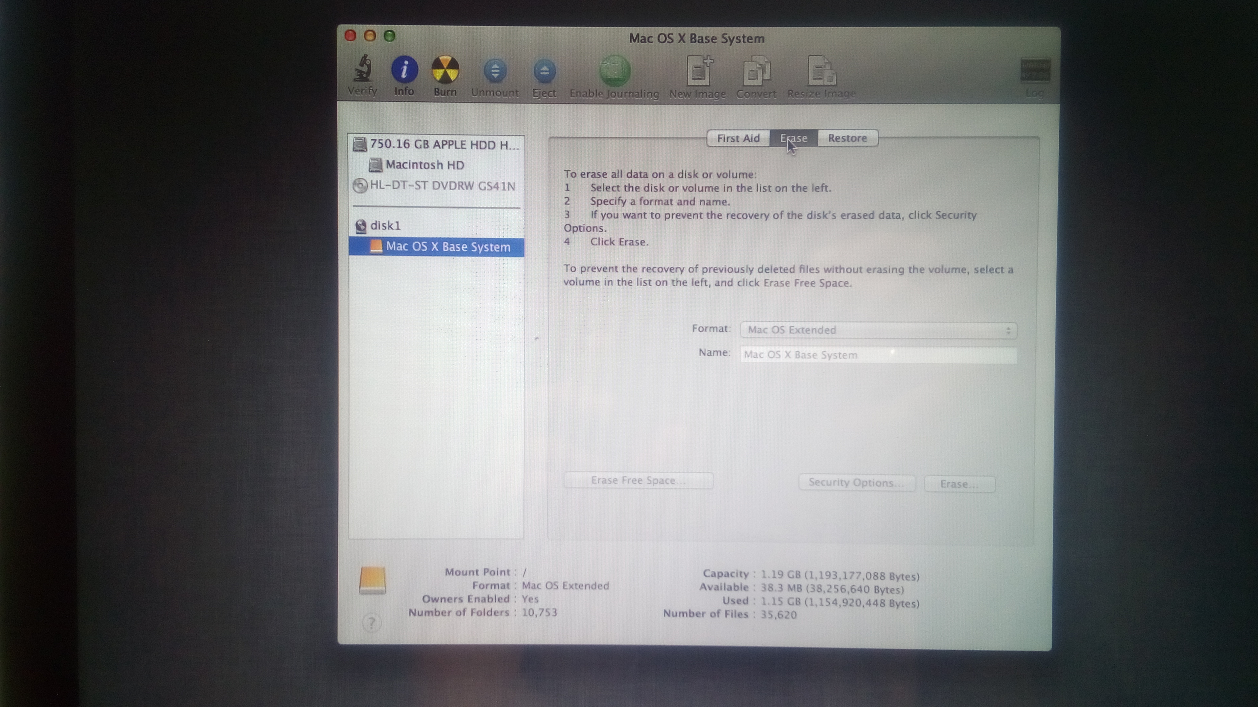

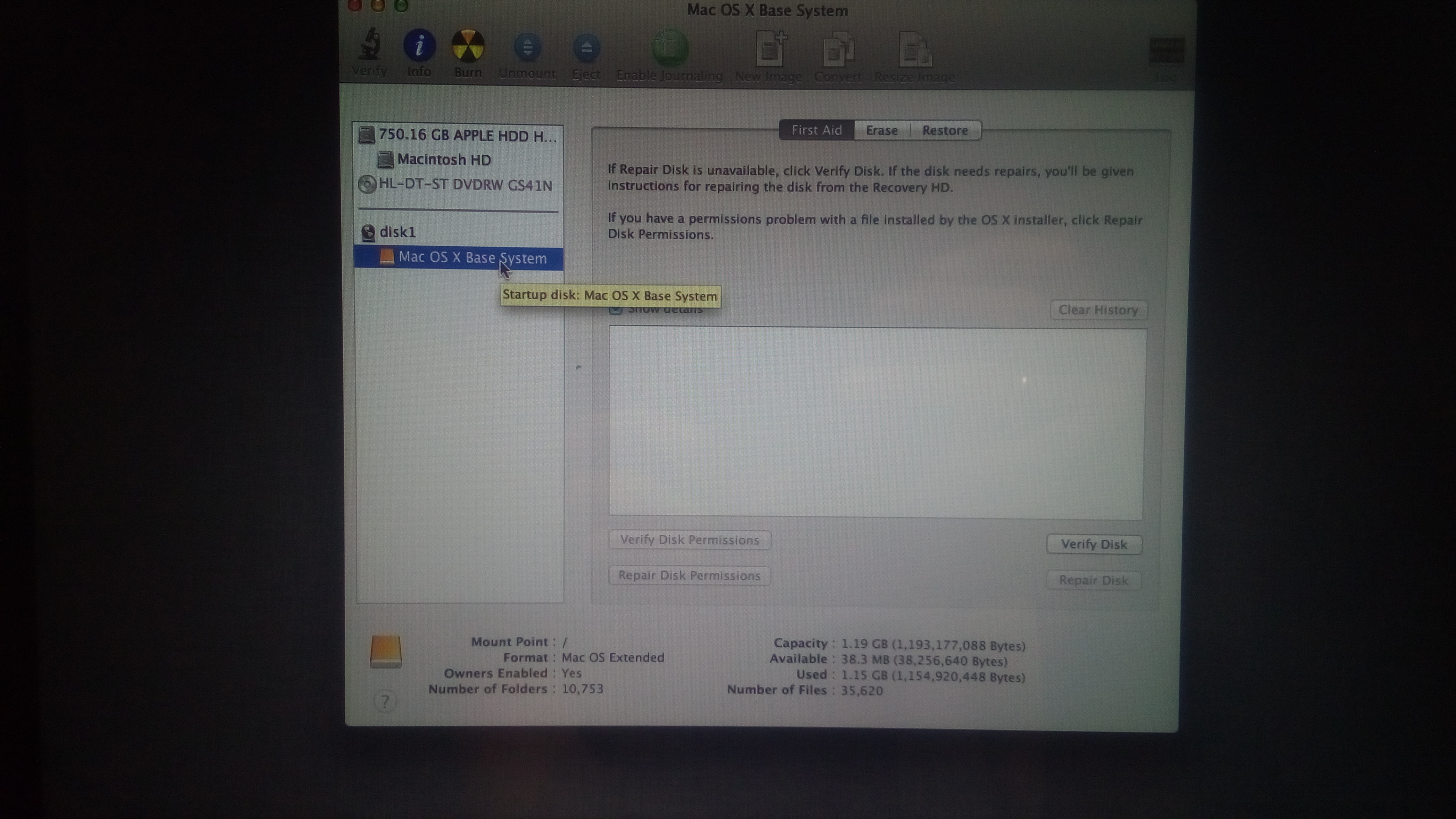

In your pics above...
- 750.16 GB Apple HDD -- this represents the physical hard drive in the MacBook
- Macintosh HD -- this is your "main partition" (on which the OS, your accounts, apps, all reside)
- HL-DT-ST DVDRW GSR1N -- this looks to be an internal DVD drive ??
- disk1 -- I'm going to guess that this is the "recovery partition"
- Mac OS X Base System -- this is the copy of the OS on the recovery partition that "gets it booted" (when you choose to boot from the recovery partition)
YOU DO NOT WANT TO ERASE THIS. LEAVE IT THERE.
If the computer is booting up this way, and you can log in and get to the finder (this is VERY important, that you can LOG IN and GET TO THE FINDER), then you should be able to "migrate your data" over from your backup.
3x yes
I'm not sure about that, since this Disk1 and the Mac OS X Base System where there already before I did the recovery install of the fresh OS. This fresh OS is now on the main Macintosh HD, the partition above. I think I now have OS 2x installed... So, when I boot in the normal way, it uses the faulty OS on the Disk1 partition, but when I boot the fresh OS from the 750GB HDD disk which I can select (see last image) then I can boot into finder, and everything works an usual.
So my question would be: I suspect this partition with this OS is faulty, since when booting with this one I get the 'prohibitory sign', so can I erase/reinstall it?

Edit: When checking Disk Utility via finder running the fresh OS, the Disk1 partition is not shown (it's already set at 'show all'). Is it gone then?
Edit2: Yes it's a Mid-2012 13" MBP, 2.9 GHz i7, 8GB DDR3 and 750GB HDD
