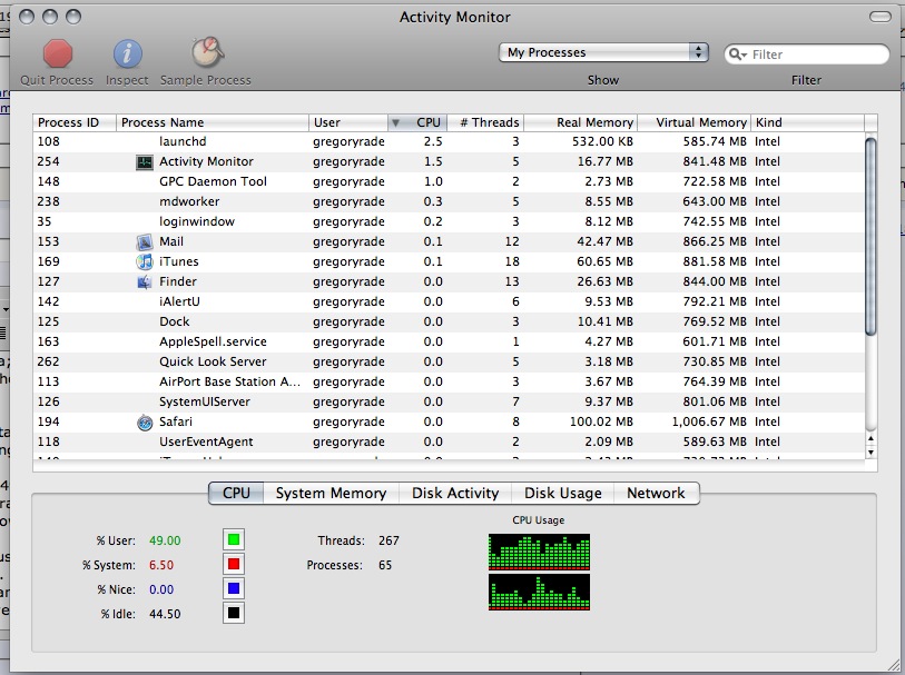

Before you go, did you use Activity Monitor or Top to make sure there wasn't some CPU hogging process you didn't know about?
Activity monitor. I take it thats bad 🙁 . Activity monitor says that the majority of cpu being used is for launchd and activity monitor itself. I've attached a pic, just in case you notice anything that i haven't =P

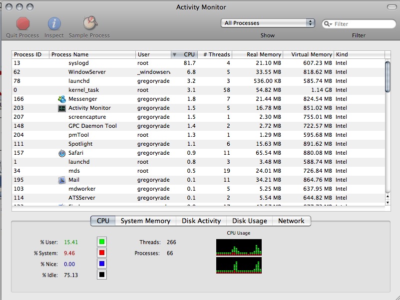

actually, the fans just started spinning after my temp reached 80 whilst i was typing on here. Plus I also use (and have always used) SMC Fan Control, so that i can manually control the fans if i want, Which i have been using a lot since I've noticed this problem.

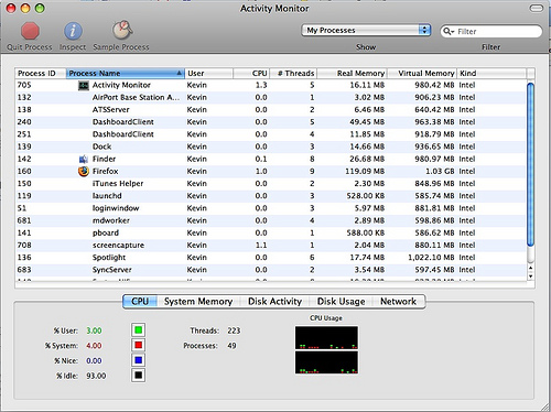

Judging by your Activity Monitor snapshot it looks like your CPU is pegging out one of the cores. Did they do a reinstall of software, doing a Time Machine backup, or Spotlight index? I would restart the machine and then take a look at Activity Monitor. If it still looks the same then you have a problem with your OS or app. Here's a snapshot of my MBP with Firefox running. Notice a difference? To see all processes that are running you need to select "All Processes" in the drop down box in Activity Monitor. The static electricity build up can be coming from the fans running overtime or the fact that either your notebook or the printer is not grounded so there is a potential difference in charge between the two devices. It's called a floating ground and it's pretty common.

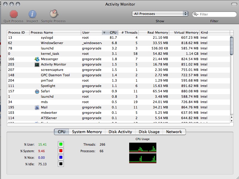

I think you've hit the nail on the head there. After constantly studying activity monitor for the last 20 mins I've noticed that every now and then a process called 'syslogd' pops up and is an absolute cpu whore. sometimes its for a sec, sometimes for minutes on end. And as the attached pic shows, its not always hogging the cpu as severely as before. But still, its enough to make my temp fly sky high.

Ok, I think I've found the exact problem. It's time machine. Apparently, it isn't a widespread problem, but when time machine is on, it can sometimes make syslogd go absolutely crazy on the cpu. I have only recently bought time machine, just before the repair i fact. Though i was always lead to believe that time machine took up hardly any processing power, with the exception of the hourly backup making the slight dip.
http://www.macosxhints.com/article.php?story=20071030233438149
