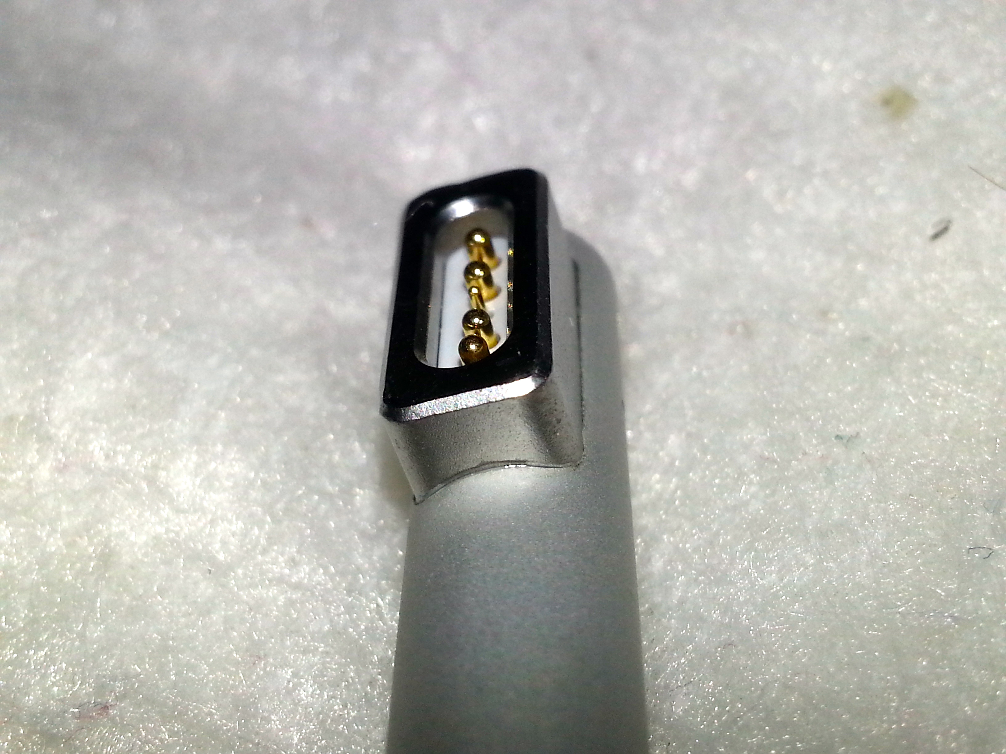

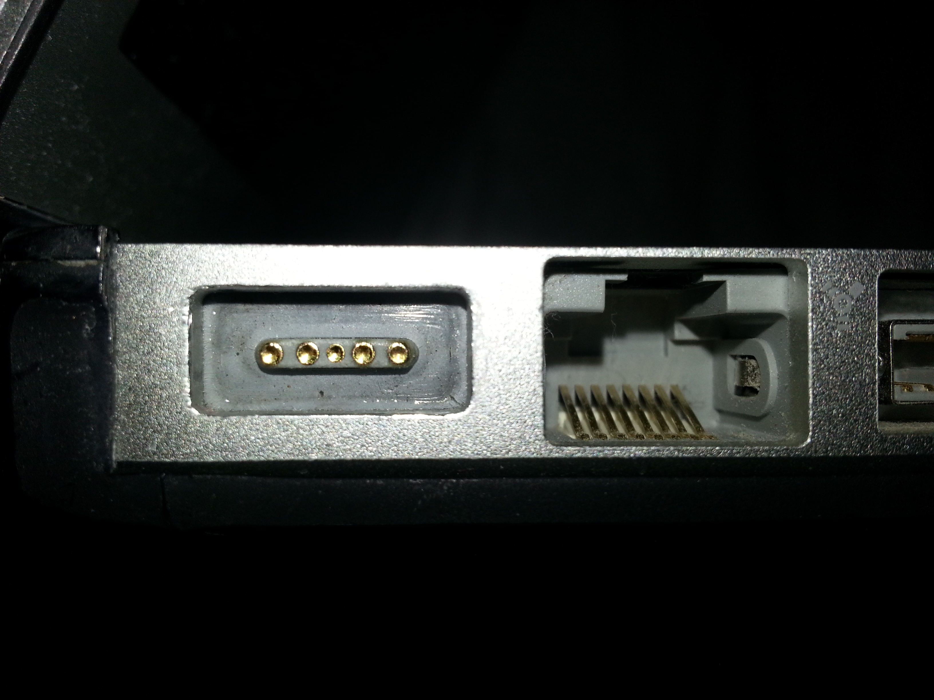

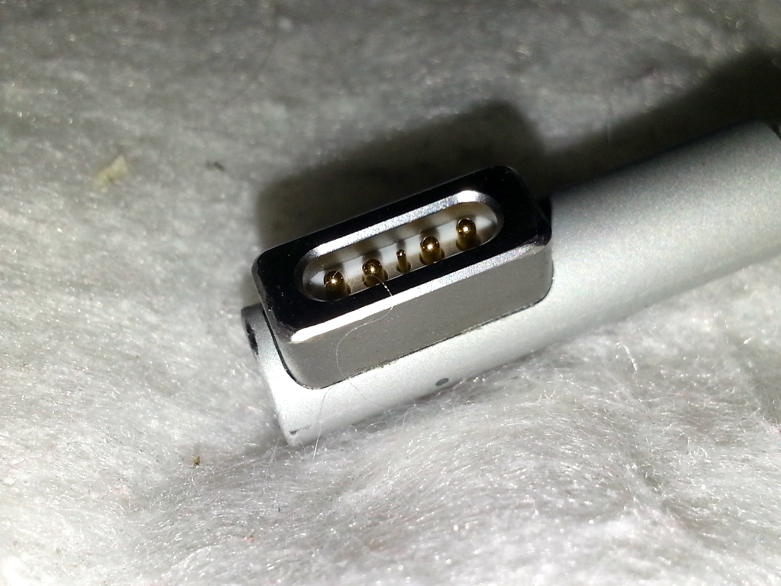

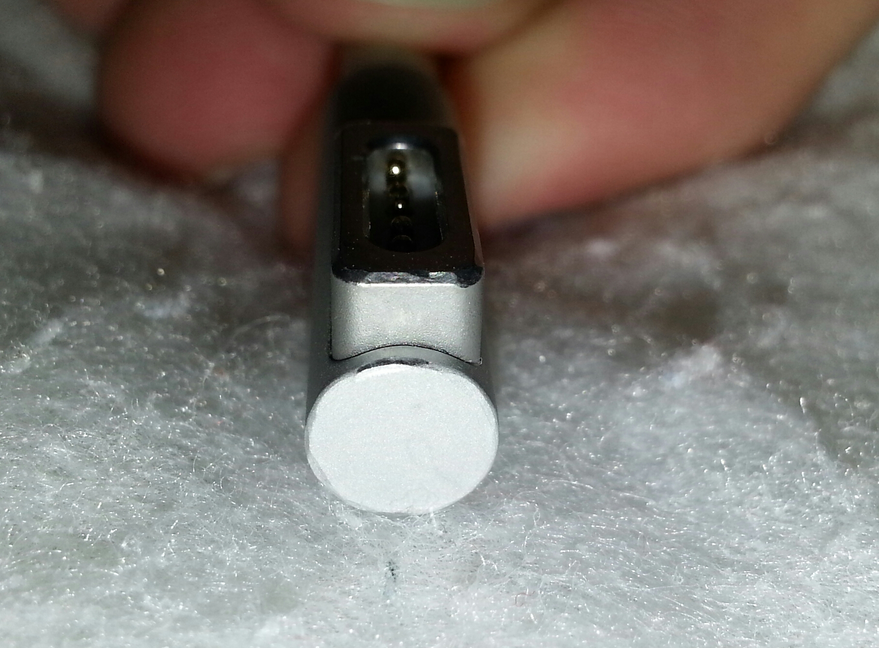

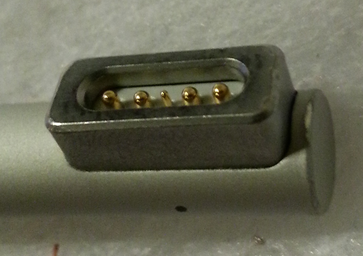

When I look at the plug on my mbp, it looks fine, and the only thing I can find on the cord plug is a small ding on the top portion. I have tried my best to attach a marco pic so you can see. On the last pic, I zoomed it in, its not the scratched paint on the top of the plug but you can kinda see the indents on the piece that connects to the mpb. Thanks
Does it work on other macs? If so, try doing a SMC reset of your computer. If that doesn't help, I think you should take it to the apple store.
Take it in to an Apple store, AASP or calls AppleCare. It may be the A/C adapter or possibly the plug on the laptop itself. It's hard to tell from the picture but it does look SLIGHTLY melted, although it could just be the lighting.

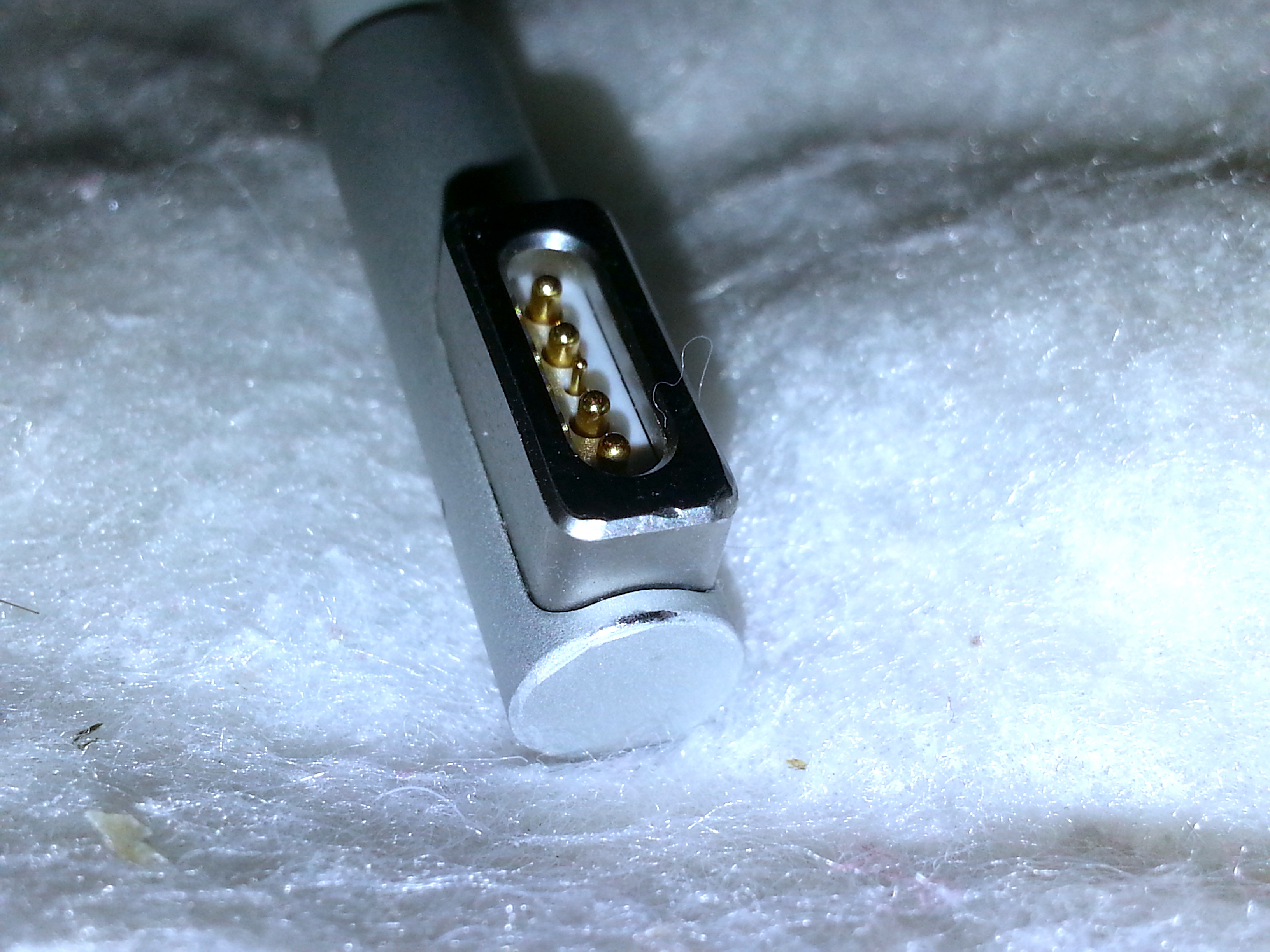

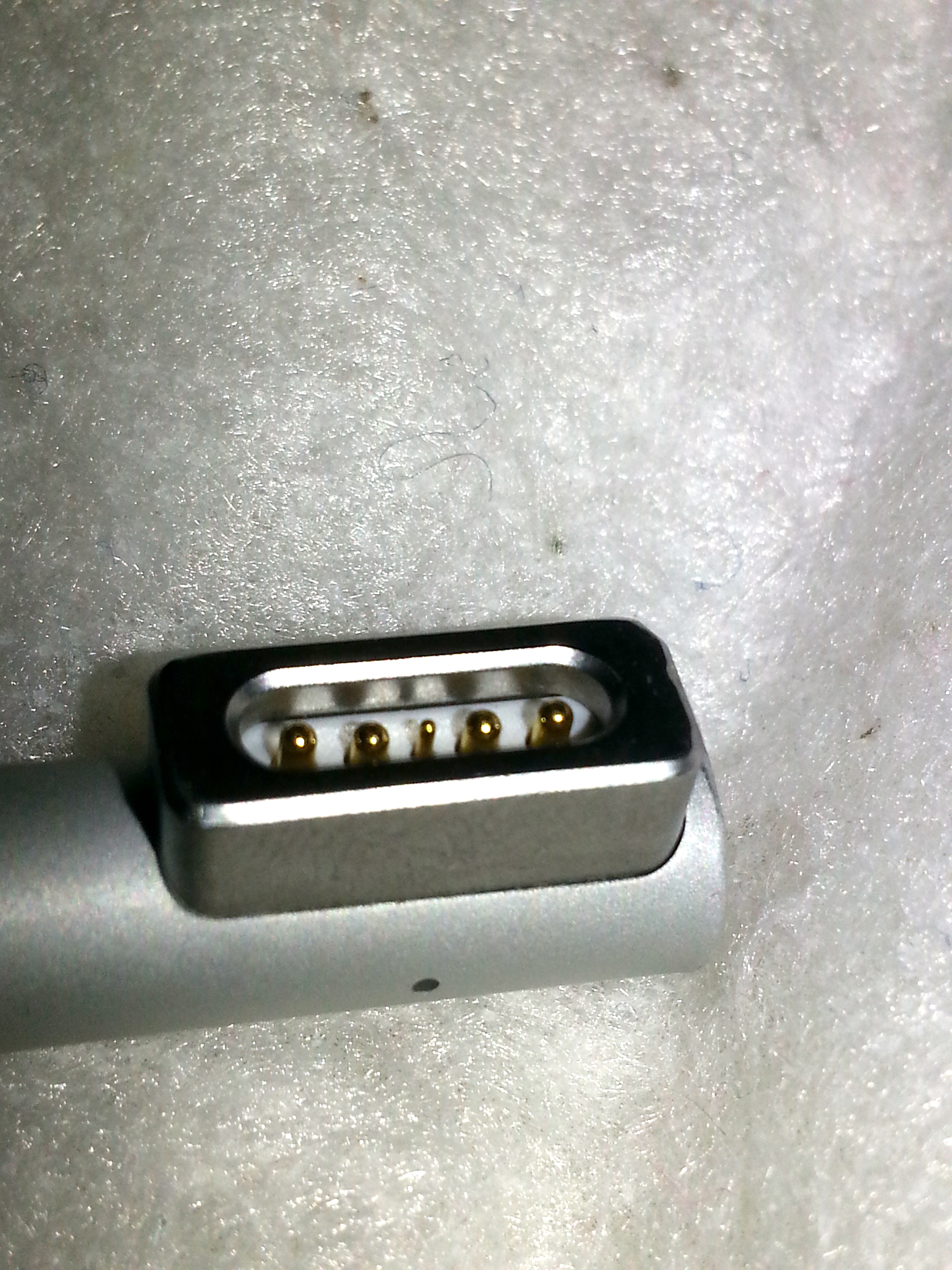

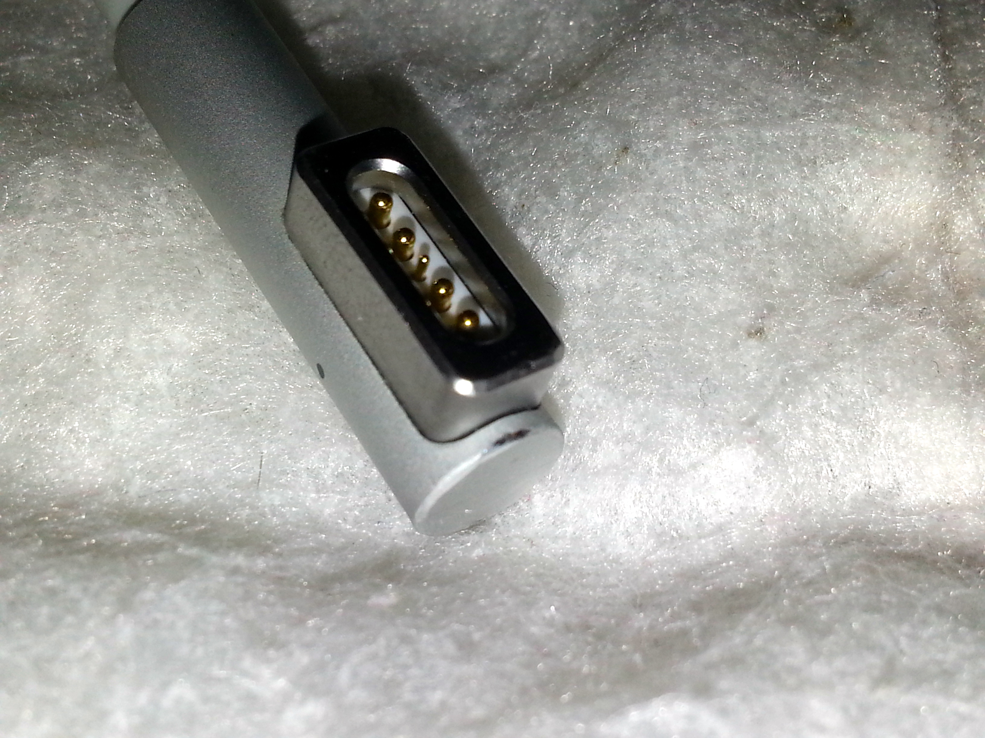

I took some more pictures from each side.
In the first one at the top of the power adapter you can see the ding and in the last one you can see it from a different angle.

Took the computer and power adapter in tonight to the Apple Store.
The genius was very nice and explained to him what it was doing and that I cleaned them out as well. He told me they were "sparking clean" lol. Then he tried it out real quick and it screwed up while I was there! I was so relieved. He put it down as a "Issue: Adapter strain relief"
He looked up the Applecare status, which was still good, went to the back got a replacement one, signed the iPad and walked out with it and my laptop! Couldn't be happier!
