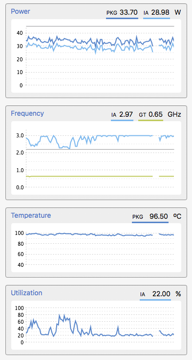

I assume it's not normal for a 17" 2011 MBP to be running at 95C while under 22% load. I'm thinking about taking it apart to reapply the thermal paste but wanted a second opinion.

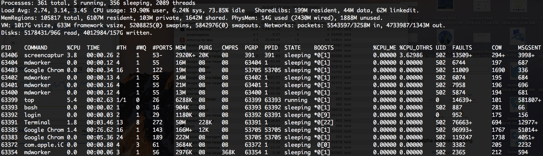

I did take it apart and it's very clean, no visible dust in the heatsink fins. The fans also seem to be operating correctly, no weird sounds from them. I noticed the fan was running very often when I was just doing light tasks, so that's why I started looking into CPU usage and temperatures. Is there anything else to check before I go the thermal paste route?

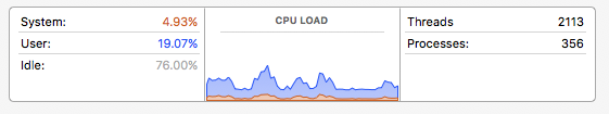

It’s clearly trying to boost abs it’s power consumption is rather high too. Are you sure there is nothing intensive running in the background?
I checked and it's mostly just chrome or macos processes. 20% load is a little high, but I generally have 5 -10 tabs open and a few other applications.
