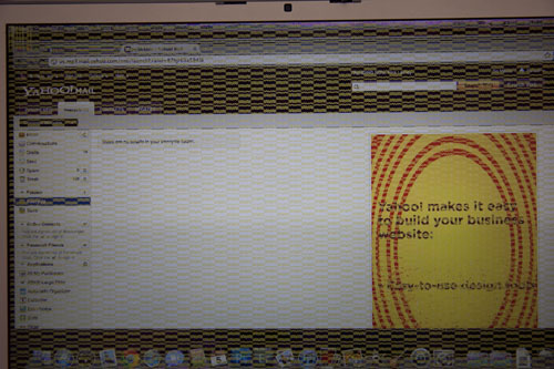

Hi, I bought a used MBP, I know this is risky, but it was the only thing I could afford right now. I spent a long time going over it with the person I bought it from and there were no problems I could find. However, on further use, the screen occasionally goes a little crazy. It gets a yellow striped checker pattern all over it. A restart fixes the problem, but I'm wondering what you think is causing this. Is the screen going bad or is it something esle? The computer is a 15' MacBook Pro with 8GB RAM and a 500 GB Hard drive which is partitioned to run Bootcamp. I have attached a picture of what the screen looks like. Any help you might offer would be greatly appreciated!

Those MBP's cannot take 8Gb without being unstable. Pull the extra 4Gb out and see if things improve.
But it looks like your graphics card is shot.
Problem solved!
I pulled one of the RAM units but it didn't make a difference. In the end though, I lucked out. I took the machine in to the apple store and it tested positive for the faulty Graphics Card. It's more than a 1000 dollar repair but they are going to cover it...sigh of relief! Also, I asked about the RAM and they told me that while the machine would not use all of the 8Gb, it usually won't hurt to leave it in, and just to remove it if things become unstable. Thanks for your help!
