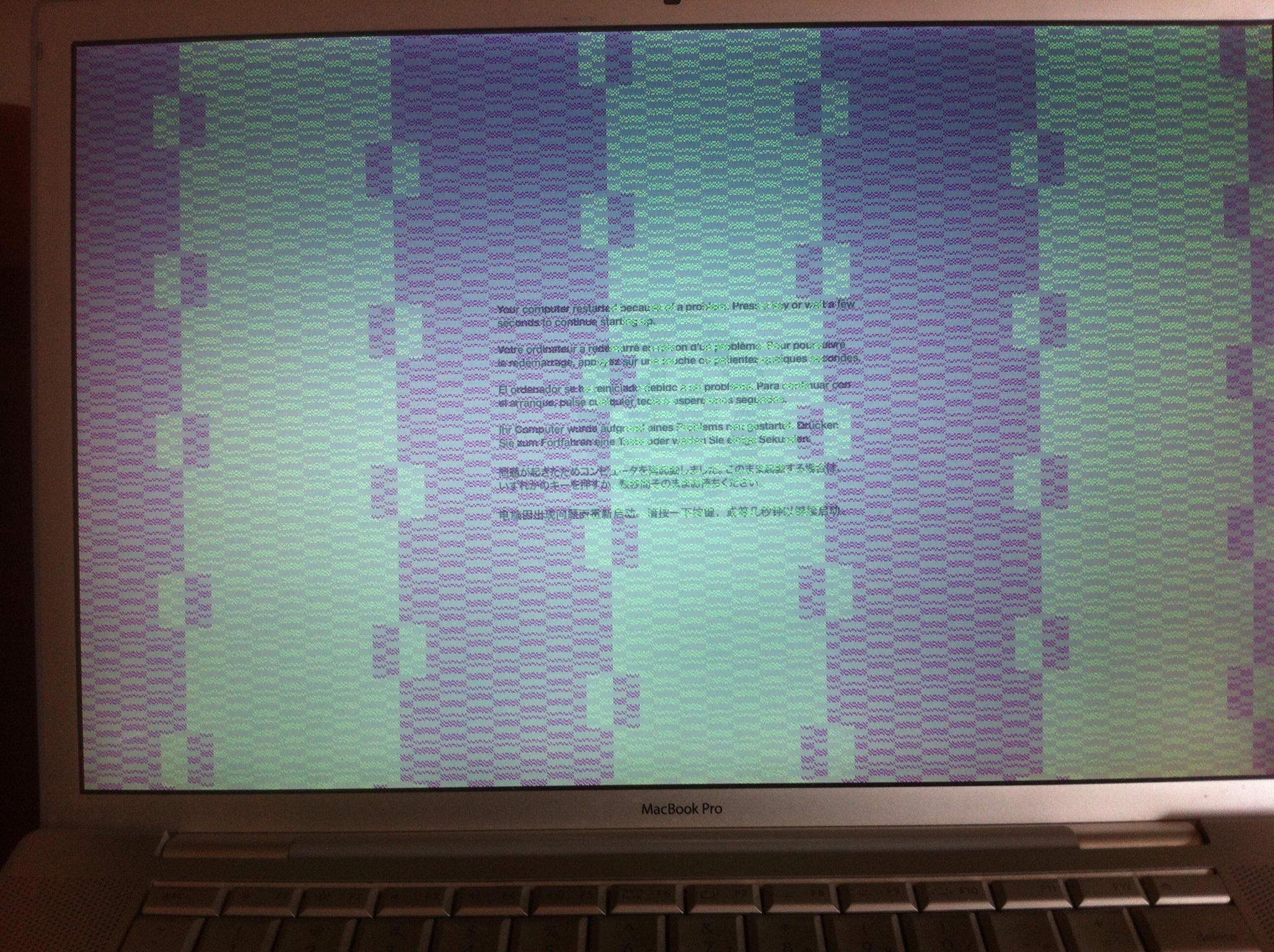

My older 15" MBP 2008 2.2/2.4 GHz has big Purple and Green Blocks running vertically down the screen it also has a message that is hard to read but says roughly
"your Computer restarted because of a problem press any key for a few seconds to continue starting up"
See attached photo.View attachment 362230
Any ideas on what I should do before forking out the $$ to get it looked at.
It's not our main computer but I would like to get it running again so that the kids can use it.

Looks like GPU failure to me. You may be lucky and it's a loose connection to the screen but I've only seen that once before. Might be worth taking it the a store to get them to have a look as a loose cable will be easily spotted. If it's a GPU failure then that's going to be pricey 🙁
Good luck!
EDIT: If it is a loose cable, I cant see how that would be reported as 'a problem' by the system..
If your MBP contains the Nvidia 8600 GPU, and this is an issue with your GPU, then Apple are obliged to replace the logic board at no cost to you. Just take it in and let them have a gander.

It's just over 4 years old now and the recall in the link that T5BRICK posted says that they'll fix for free if it's less than 4 years old.
