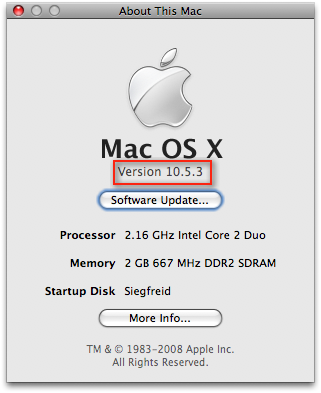

You can get it from two places:
1. Apple Menu -> About This Mac. Click on the the text for the Version number and it will change to the Build number. Click on the build number and it will show you the system serial number.
2. Inside the battery compartment.

just out of the curiosity, what do you mean by the next text? you mean the hardware overview tab right?
If you click the highlighted text it will change to the build number of the os and then to your serial number, however when you have had the logic board replaced I think it is empty as it refers to the same string.
