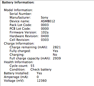

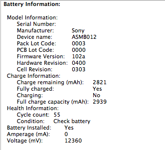

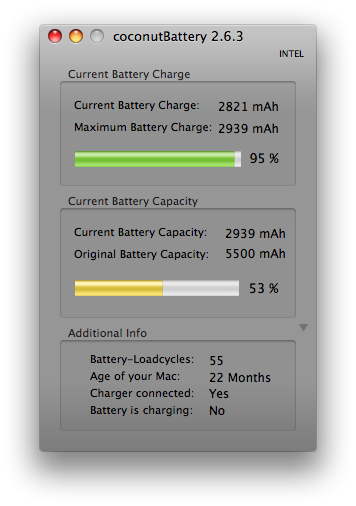

Thanks to everyone for all the replies, I didn't realize that this was becoming somewhat of a widespread issue. Several others on the Apple Support forums seem to be having very similar problems. I've attached screenshots from System Profiler and CoconutBattery showing that the battery isn't in great health but it does have some juice left in it...It seems like it should still be able to power the computer. The problem began before the 10.5.5 update so I don't think that's the issue. I'm going to take the MBP into the my local Apple store tomorrow...I don't have AppleCare (purchased the computer in November '06) but I'm hoping the battery might qualify as defective. Worst case scenario I end up buying a new one...I'm just glad it sounds like the problem is isolated to the battery.

I had the same issue a month after I bought my 17in MBP. I took it into the apple store and they just exchanged the battery. Problem solved never happened again.
One trip to the Apple Store and $140 later, I have a brand new battery and everything is working fine again. I wasn't able to get a free replacement based on the recall, as apparently is was only for Core Duo (not Core2 Duo) machines. I'm definitely going to be much more attentive to taking care of the battery this time around.
