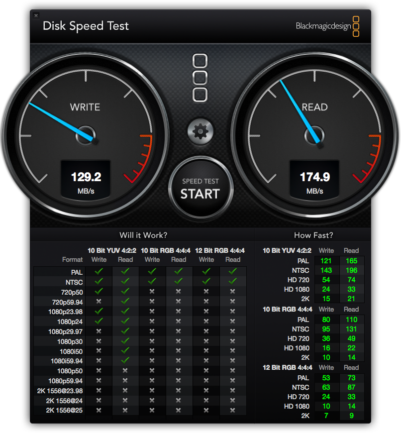

Detached and reattached display connector. The computer booted up fine. Only complaint now is my write and read speed at ~130 and ~175 respectively.
Tried Steps to increase speed:
1. Reset SMC
2. Installed Trim Enabler: standard reboot without increase. Rebooted under "cmd r" or single user i believe it was called to trim the SSD also without an increase in speed.
3. Firmware is up to date
Anyone know how to increase my SSD speeds with a Early 2011 MBP 13"?

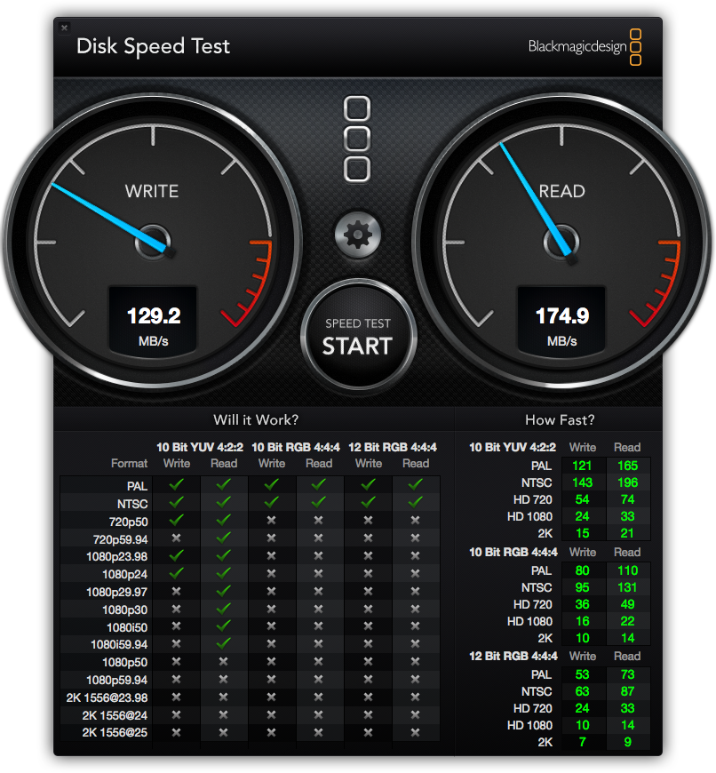

1. Reset SMC
Not sure what the problem is, but did you format the drive before installing it, and what OS are you running? If Yosemite that might conflict with trim enabler.
Formatted it to the Mac Journal or whatever it's called. The trim_enabler does conflict with yosemite. However, I disabled Trim. Still sitting at about 100 write and 150 read. The the only three other problems I could think of were:
1. Firmware incompatibility
2. Faulty SATA cable (had replaced a few months ago by an apple certified repair store). In addition to if the guy used a SATA II cable instead of a SATA III.
3. Faulty logic board
- Joe

Kingston conned you and a lot of other customers. They switched suppliers for their flash chips and controller to an inferior one.
I'd say return the SSD and get a better one like Crucial or Samsung.
Here's the ripoff Kingston did: http://www.anandtech.com/show/7763/an-update-to-kingston-ssdnow-v300-a-switch-to-slower-micron-nand
⬆︎ this..
Doesn't sound like the logic board, probably the SSD.

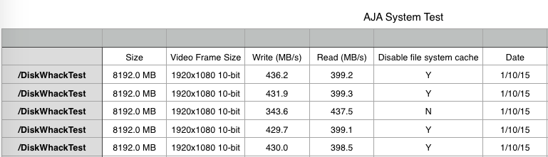

So I switched the benchmark software from Black Magic to AJA Systems Test. The numbers seems match the product labeling much better. Which makes sense because I was not noticing any slowness to the system and couldn't image it being 2-4 x faster, based on the Black Magic results.

AJA and ATTO don't really reflect a drive's proper performance. In fact, Kingston uses ATTO to mislead customers on a drive's performance.
CrystalDiskMark and Blackmagic provide the best ones.
