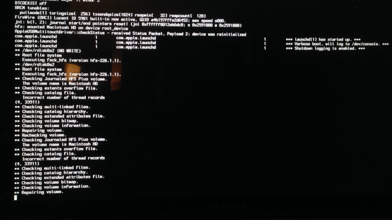

Thanks for your response, koolaid
Here is a screenshot of the outcome:
Also, I found a few similar threads (although nothing quite the same), which prompted me to run OSX in recovery mode and try a disk repair.
This is the error I'm getting:
