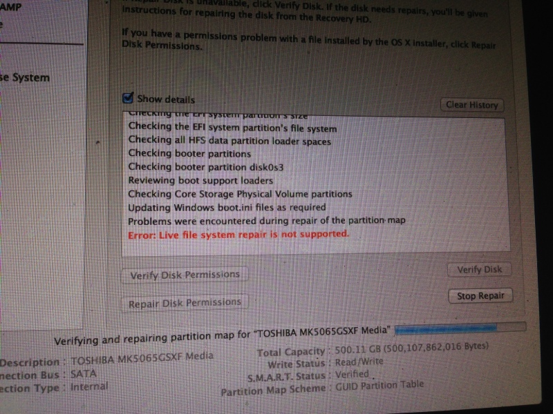

So I updated to Mavericks a couple of days ago and everything seemed to be working fine, until last night when my computer ran out of battery and turned off.
I plugged in the charger and tried to boot it up but I keep getting the Apple screen with a grey loading bar just underneath the logo. Takes it about 5-10 mins every time and only reaches about 9/10 of the way when the mac shuts down and begins the entire process again.

What you describe has happened loads of times before but this is definitely different. The loading never completes all the way to the end because the machine reboots just before. Tried this at least 7-10 times but always the same thing.
I found a few similar threads (although nothing quite the same) which prompted me to run OSX in recovery mode and try a disk repair.
This is the error I'm getting:
