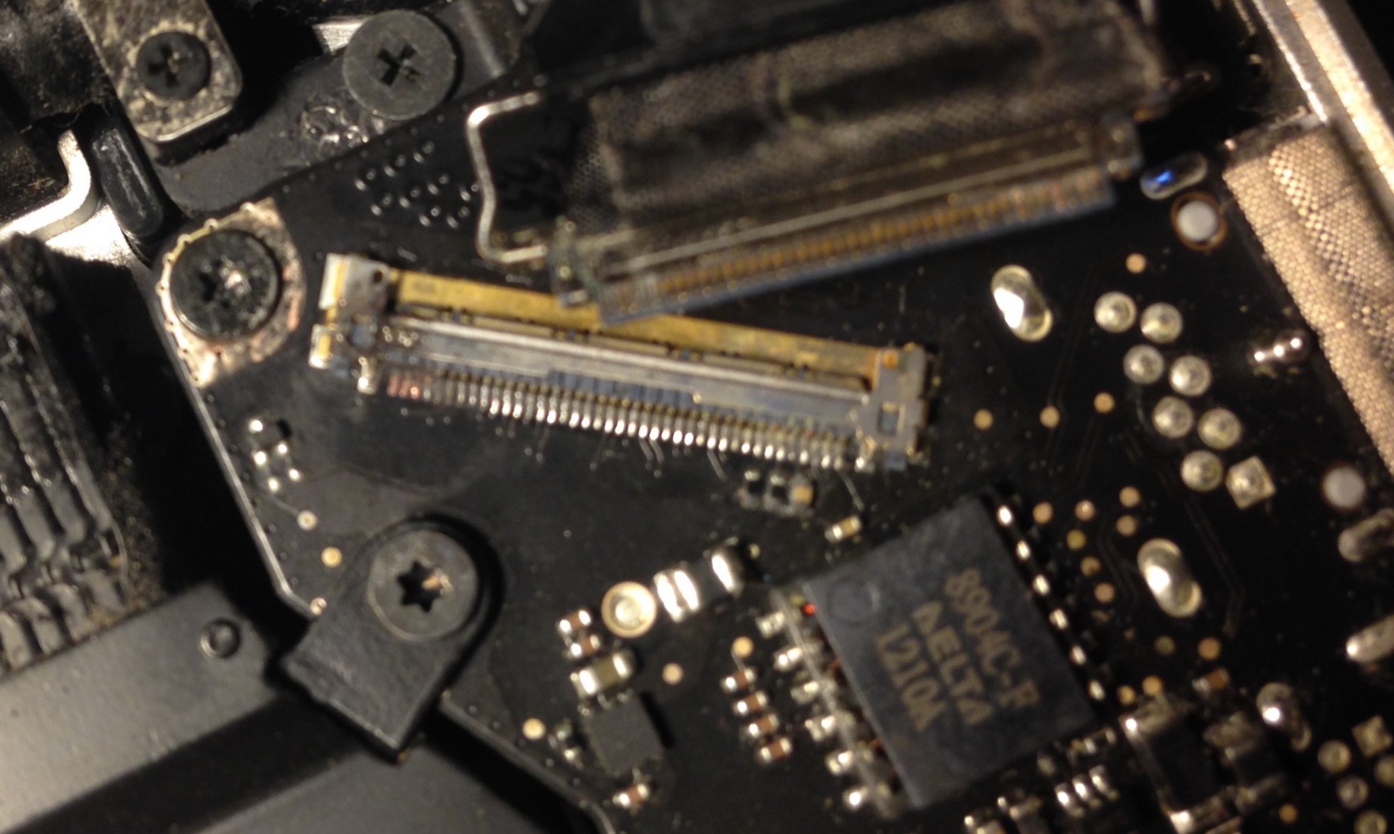

I cleaned it but no results :-( this is a photo of the display connector. If you look closely it seems like two or three of those tiny pins on the left-hand side are simply not there, would it be crazy to think they somehow disintegrated? Or is it normal for those connectors to be missing several pins. I don't know.
That MB looks like its recently been retrieved from the sea bed...lots of corrosion on the display connector & other components. Is that after you've cleaned it with iso alcohol?
Personally I wouldnt put much more effort / money into this judging by the state of it internally.
Yeah it's not the clearest photo, but it looks like you have all kinds of corrosion on the connect and the board itself.
No lol, I think the "corrosion" you're seeing is distortion due to camera zoom, in real life the board looks rather normal. Anyway... seems to me there's damage to those pins on the display connector. My theory is that beer reached that corner of the connector and shorted it out - amazingly the short seems to have actually destroyed 3 of the tiny pins and discoloured the metal.
