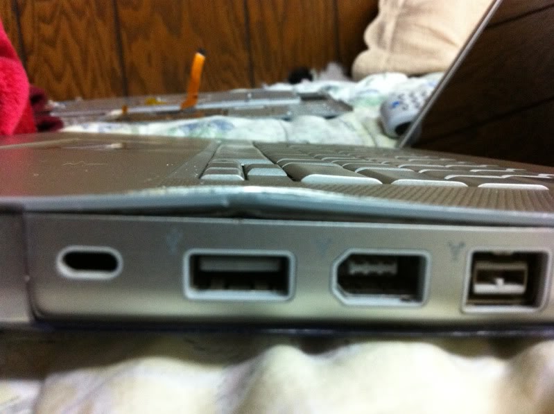

Now for my other feat to tackle.. Swapping the top case. Since I bought my MBP used off my friend it had a few scratches here and there and one dent on the right side of the speaker. The laptop itself is fine but the top case got the worst of it.
That's the damage.
So I think I could probably bend it back but I definitely don't want the gap there. Well the other day looking thru my local craigslist I found a top case for my model MBP (what're the chances huh?) for $20 the guy had two of them.

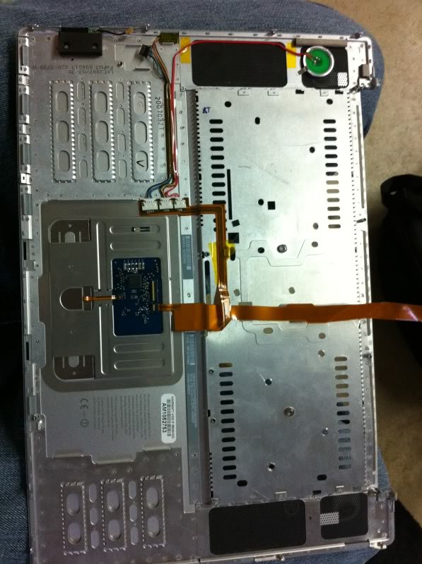

/\ overall view, looks okay, are the ribbons all intac?

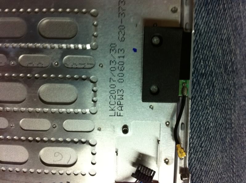

Where does this piece connect to?

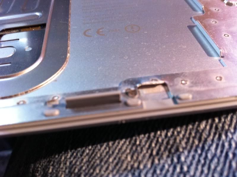

Are these supposed to be like clips? They look like they are perhaps bent and/or damaged?
Sorry bad pic.
I know you guys can't tell me if the top case assembly is working but maybe someone here can tell me if it's worth it to put it on!
Also if it doesn't work, can I just bend the original piece slowly back to it's place? Or would it snap?

i think it will work....give it a shot.
if not you should be able to bend it back in place.
keep us updated btw

Also from that guide it looks like I'm missing the Bluetooth board on the one I bought, should I bother even trying to swap my current one onto this one or is that piece delicate and hard to get out?
