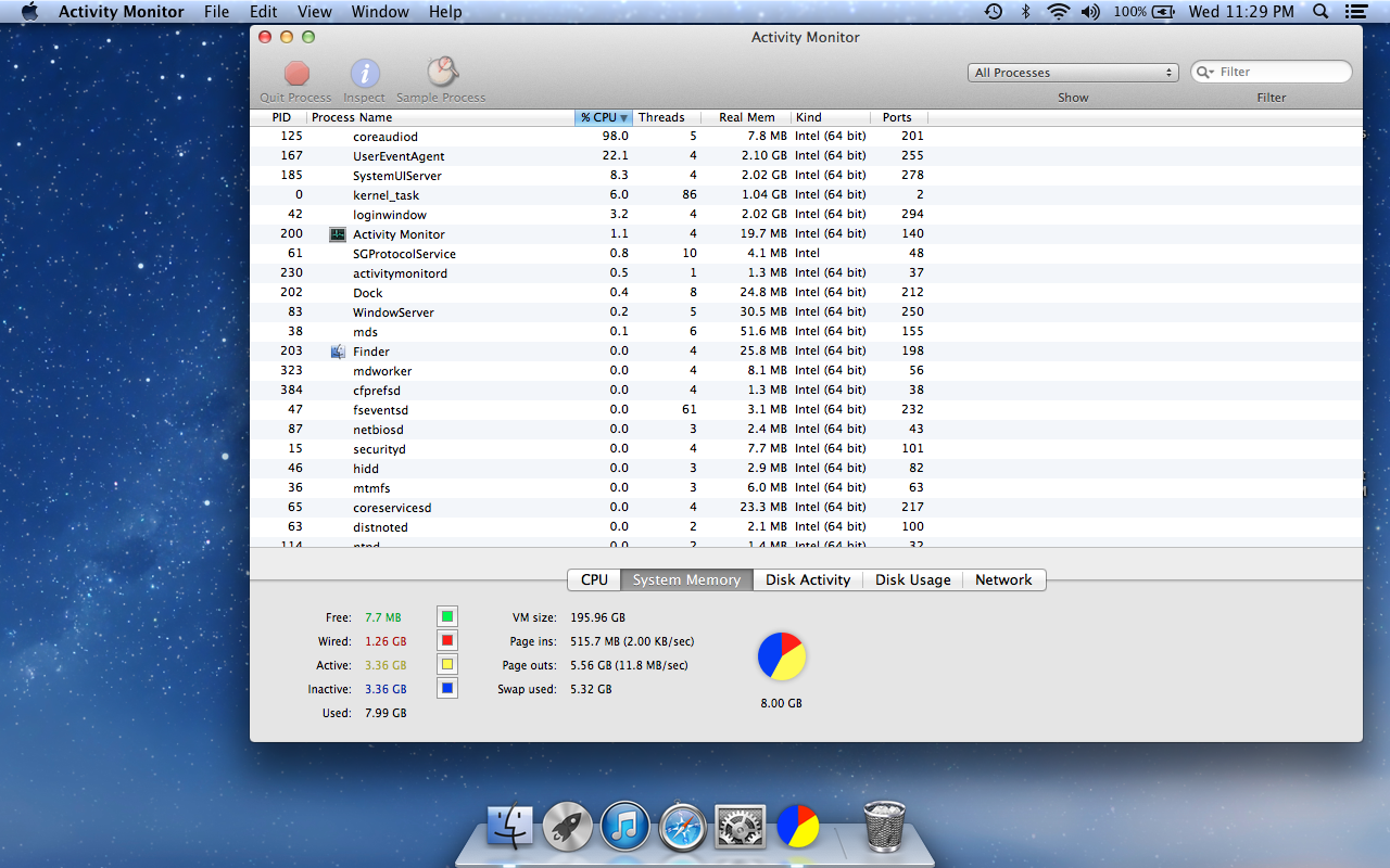

Its telling me core audio is about 98% cpu usage. no other apps are open other than safari and activity monitor.
This a shot 5 min after my computer is started. I have only had this MBP for 2 months and only loaded one heavy application, Protools. All files are stored on an external hard drive. No other apps on this computer

That's whack it page outs 5 GB's in 5 minutes with 8gb's RAM.

Thank you weaselboy for the very informative link. An audio folder had been deleted and it was causing coreaudio to go crazy. All I had to do was make a new folder with terminal following the steps in the link you provided. All is back to normal. Big thanks!
