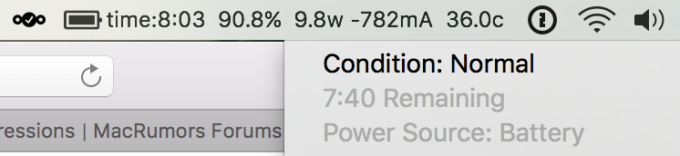

But it also messed up my battery hard. The icon will no longer tell you how much time you have left, just a mythical Power Source : Battery. Activity monitor will give you a really low estimated time, and the battery seems to go down like crazy.
I've confirmed with a different user in the EU owners thread that my BootROM is updated to MBP133.0226.B07, and I'm placing the bet that that's where the problem is at. Reseting the SMC, nvram or going back to 10.12.1 doesn't fix the problem.

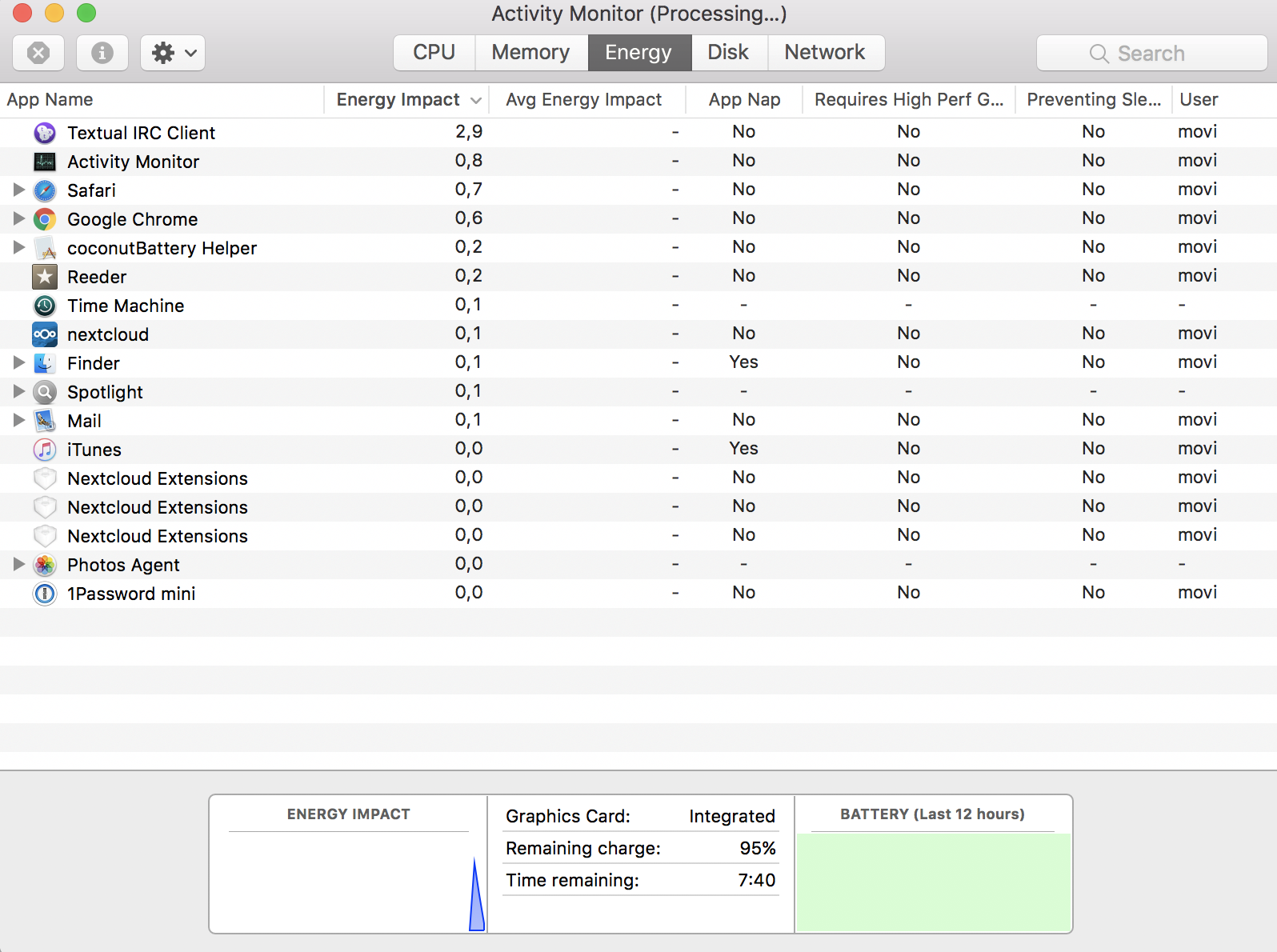

No, I don't have that app, I use coconutbattery. I somehow made it to work okay, with multiple smc reset attempts (I seriously HATE how this all works now). That said, I still get no graph in activity monitor and all of this just works weird.
The times are different because the apps poll at different intervals
[doublepost=1480687953][/doublepost]And here's the activity monitor screwing up, back on 10.12.1

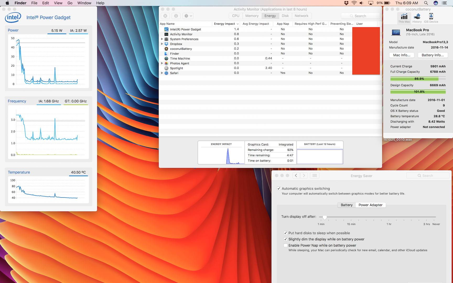

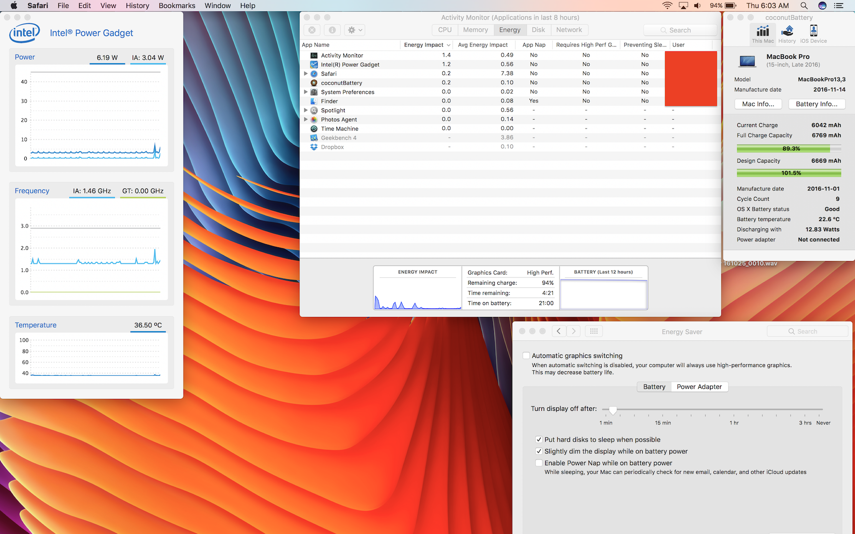

My battery has taken a dive since the latest beta. Oddly, unchecking automatic graphics switching uses less power on the dGPU than the iGPU. Figure that one out! I show 12w at idle with the dGPU and 20w when switched back to the iGPU. After a reboot the iGPU is showing 8w, which should be about normal, but then it suddenly jumps back to using 20 plus watts while still keeping idle. Screen brightness was just past 50% in these screenshots.
