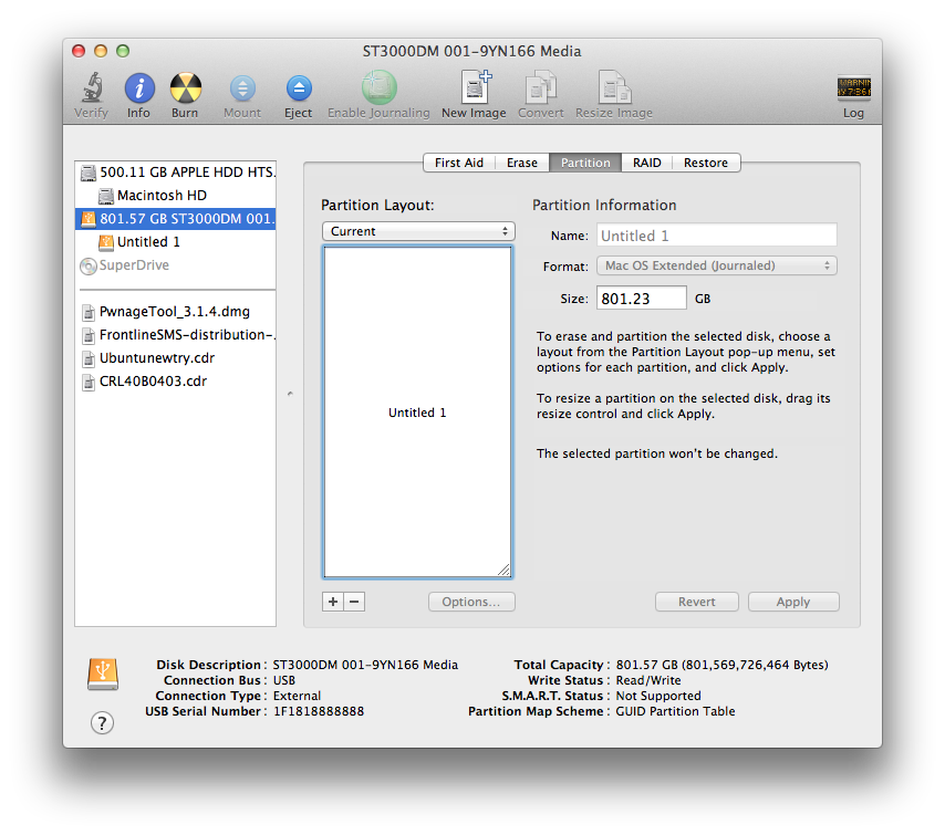

There are no partitions when I first plug it in. If I format it, it will only let me format up to 801.23 GBs.

😱 Could you post screen here? 😱
Sure. I think it is an external enclosure issue though. I'm going to check with Thermaltake to see what they say.
