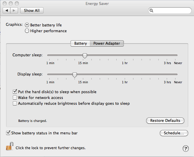

How do I set/switch between the two? How do I know which one is running?
Click Preferences > Energy Saver (under Hardware) > Graphics: Better Battery Life (9400m)
Higher performance (9600m)
If you don't see these options, you only have 1 video card on your machine (ex. 13" MBP).

I have a same laptop as you do, but I always run it in the 9400m mode. I can hardly ever hear the fans. You may want to consider opening the bottom up and clean the fans and heat ducts area with compressed air.
