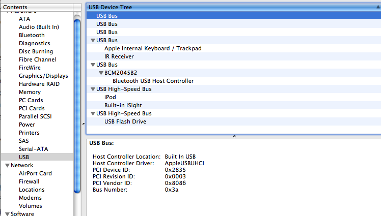

I opened up System Profiler with a flash drive in the left port and my ipod in the right port, and apparently the right port is shared with iSight. It shouldn't make much of a difference unless you are actually using iSight.

They should both work normally, and they can both provide full power to charge an iPod, but the right one apparently shares its bandwidth with iSight, meaning that if you are using something like an external hard drive on the right port at the same time as you are using iSight, you might notice reduced transfer rates to the hard drive. The original poster seems to have a defective USB port on the left side, but it sounds like it's working now.
