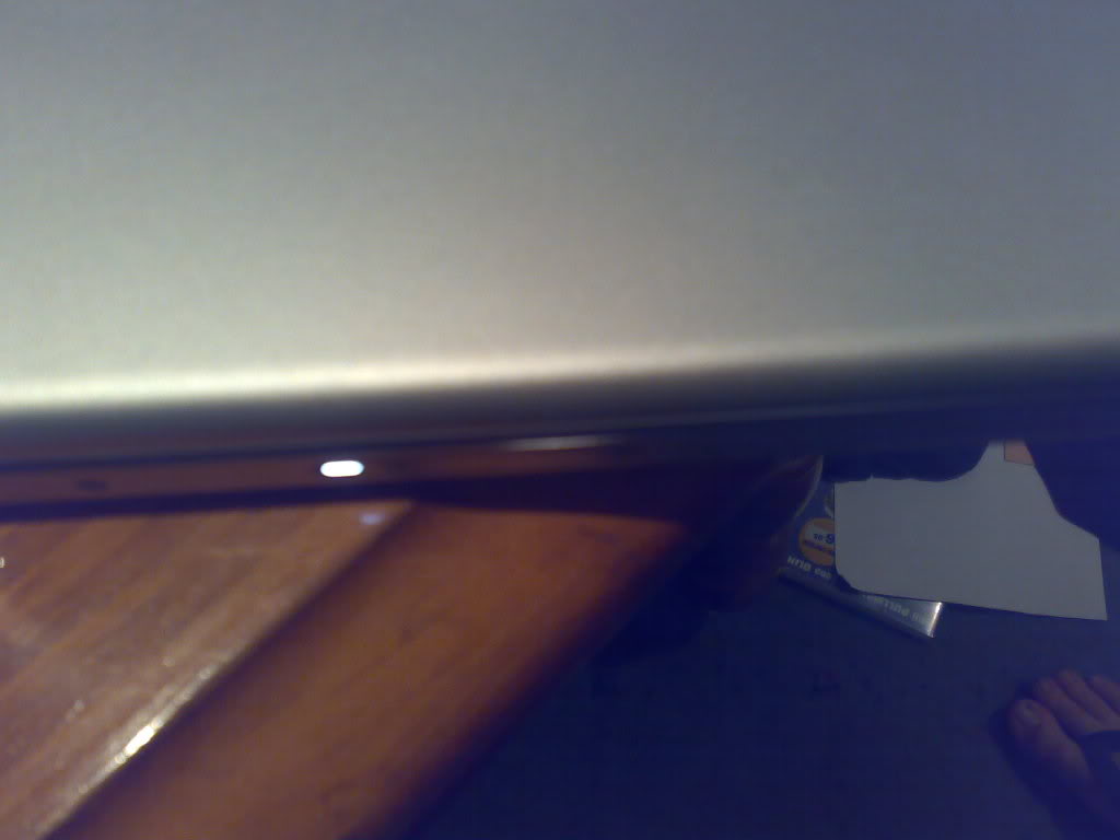

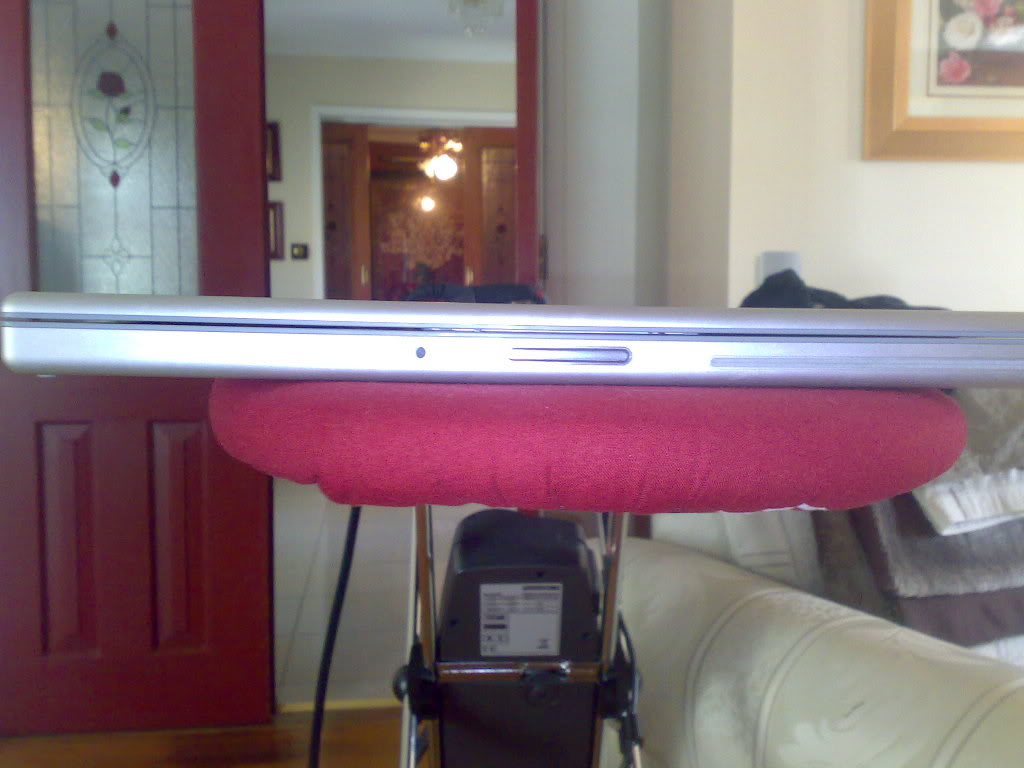

Hi, I just wanted some opinions on whether to take this to apple or not.
I bought a top end MBP 15' on 22nd Jan 07. My face hurt from smiling that much that day. It was beautiful. But after a couple of days I noticed a very slight protrusion from just above the latch release.
Also the lid sits flush at one end but not at the other.
At first I didn't think it would bother me, but after reading post's on here and realising I'd spent 4k on a computer, I thought, maybe it did bother me.
Now I know my warping is no where near as bad as others I've seen so I wanted to know if you thought I should do anything about it.
Also what do I say to the Apple Store guy if I take it down there.

None of the models at the Apple stores I have been to are like that - it is a warped case, and its not supposed to be like that.

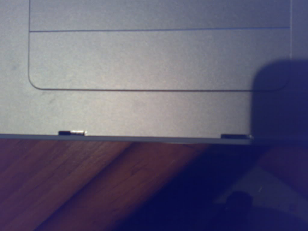

If I'm looking at the right thing - the second photo shows it the best - the thin strip of casing above the latch release protrudes out, and if yours is like this, Apple Care will cover it - unless of course its due to damage that you caused.

And why oh why oh why do people post pictures that are really blurry (2nd pic)?

That is exactly what I'm thinking, it is only minor, and it probably is a nitpick. But its my new baby, and I want it to be perfect haha.
I certainly didn't cause the damage I've only had it for 3 weeks and it was fine out of the box, I can only assume the heat caused it to pop out.
As for the blurry pic. Shoot me. It was taken on my phone.

I took it down to my Apple Authorised Service Provider - we only have one 'Apple Store' in Australia, and I think it's in Sydney - and she said she'll tell Apple what she see's and it would be up to them to decide whether it's covered. She said it probably won't be a problem and should only take a few days.
She also told me it was a major job - the whole bottom casing would need to be replaced - and she had only done it about 15 times. That scared me a little bit. But I'm sure it will be fine.
So I'll report back in a day or two and let you know how I go.

so apple care tell me on the phone today that it has been escalated and bought to the attention of there engineers who will decided if it is a manufacturers defect and therefore whether it will be covered, clearly it is, and I'm confident it will be repaired, but until then, I've got my puter back.
