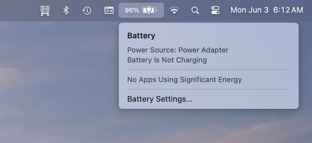

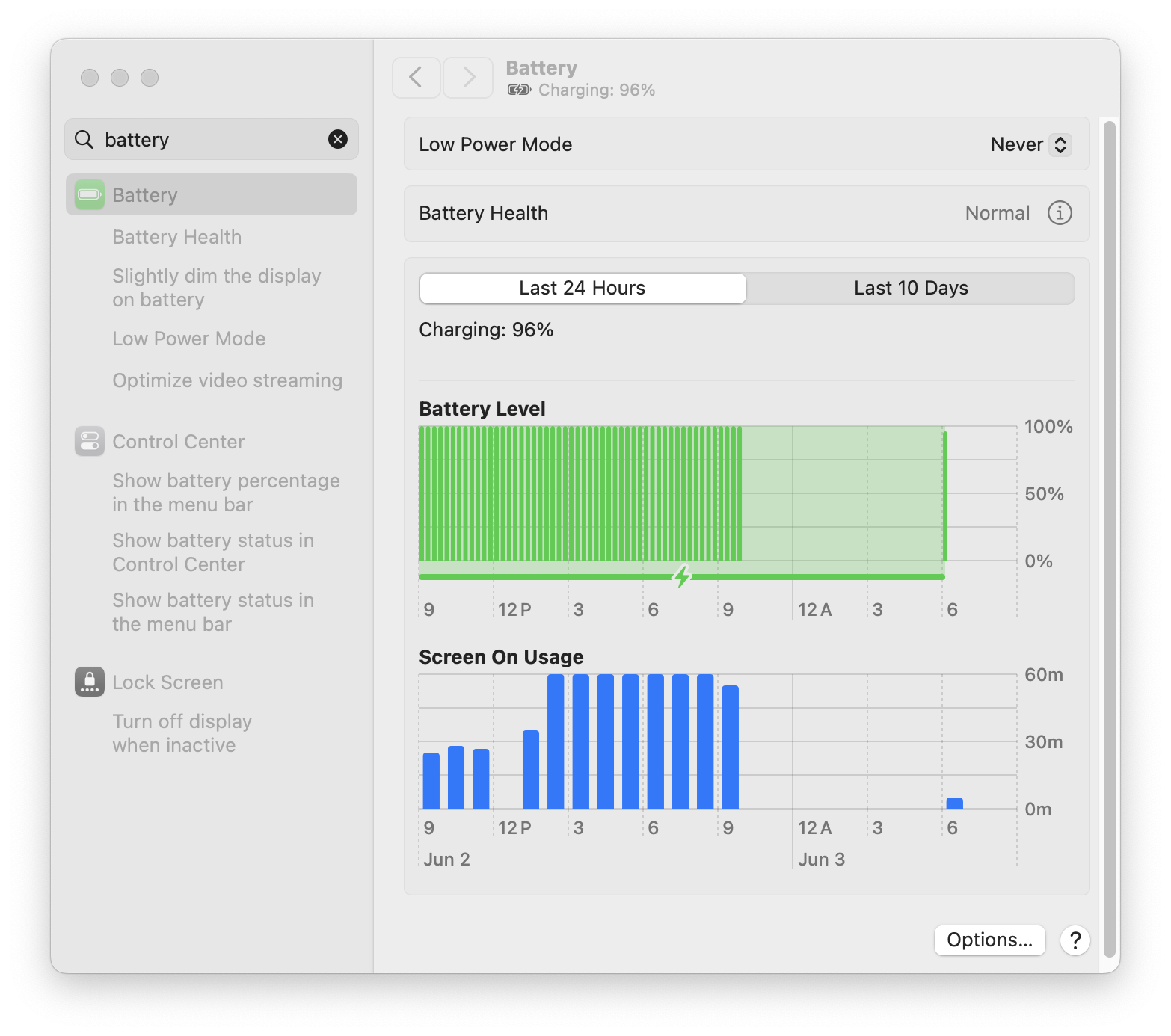

I'm seeing weird battery charging behavior on my new M3 MBP and I'm hoping someone here can help me decide whether it's due to a bug in
Sonoma 14.5, a problem with the power brick, or a hardware problem with the laptop. It's connected to power almost all the time, with a green light on the magsafe. Optimized battery charging is on, and there are less than a dozen cycles on the battery so far.
Periodically I will notice that the magsafe light has changed to amber, and the battery indicator in the top bar shows that the battery level has dropped to 96 or 97 percent. Clicking the battery icon shows the power source to be the power adapter and the battery not charging. Looking at the battery in System Settings, however, shows the battery to be charging at 96 or 97 percent.
When things get into this state, they stay that way as long as the magsafe is connected, surviving reboots and shutdowns. Turning optimized battery charging off 'until tomorrow' changes nothing.
If the magsafe is removed, the charge level indicators stay the same, no matter how long I wait, until the laptop is shut down and restarted,
after which the charge level might show anything between 25 and 99 percent, depending on how long I ran with the magsafe removed.
I ran hardware diagnostics and no problems were found. Searching the forums here turns up a lot of complaints about optimized charging, but nothing quite like what I'm seeing.
Am I alone in seeing this strange behavior? Is this hardware? Software? Besides "call Apple" can anyone offer any advice? Thanks!

Thanks for the reply. I've considered AlDente but don't want another variable until I'm sure it's not a hardware issue. Apple support had nothing, except to agree that it's a strange problem. The support rep insisted that I reinstall Sonoma. I did, but since the disk wasn't erased I doubt it helped anything. Now waiting to see what happens.
I've never seen Charging on Hold, even though the laptop stays on the charger pretty much 6 days out of 7, but I've had the laptop for little more than a month now. Maybe it takes longer.
This is (mostly) expected behavior.
This is somewhat strange.
For the most part masked by Apple, the power management system will take several actions with the battery, some dependent on settings:
• When the battery charge indicator reports 100% or fully charged, the battery may continue to charge for a brief time longer. Basically, this is because of the nature of current battery tech, chemical reactions that are volatile to many conditions, and the subsequent difficulty to consistently, precisely measure the state. In other words, the system may detect the battery (in its current condition) is capable of supporting more charge than the previously measured 100% capacity. You can witness the behavior via apps such as coconutBattery.
• Also when the battery reaches full charge, the system will stop charging the battery. The state-of-charge will continue to be monitored until it drops to ~95%, at which point charging will restart. The cycle will repeat until the device is disconnected from external power. When Optimized Charging is enabled and engaged/active, the cycle happens from ~75 to 80%. This helps to prevent overcharging.
— You might catch this behavior when the system finally updates the level, which can happen when the state-of-charge measurement drops a percentage after disconnecting from the external power source or a device restart/reboot. For example, you disconnect the device from power with the battery indicator showing 100%, although, the charge level is actually measured at 98. You use your device (on battery power), and when the state-of-charge drops to 97% the reported percentage is finally updated (i.e., jumps from 100% to 97%).*
• From ~80 to 100%, the system will step down the charge rate, slowing to a trickle charge. On the other side of the spectrum, at <5% or so battery level, the system will throttle down components (i.e., you’ll probably experience some lag).
* I know it’s not your exact scenario, however, another reason reported battery state-of-charge may jump, device may unexpectedly shut down, and/or the battery health/capacity may not have changed for a very long period is loss of calibration.
— (Re)Calibration also ‘fixed’ my brother’s aging iPhone XR, which he described as laggy when nearing ~30% battery and would then shut down.
Thanks for that! This may be what's going on, although optimized battery charging is on and I never see the charge level drop to/below 80%, and I've never seen the 'charging on hold' status. It's also confusing that the reported charging status in the topbar icon popup and Battery panel in System Settings don't agree with each other. It's not comforting that the Apple support rep was as confused as I am :)
This weekend I'll go through the steps recommended by iFixit to calibrate the battery.
That’s a whole other ball of yarn. Because the feature uses ML, it’s most reliable when exposed to rigid schedules.
When the feature is enabled, your Mac will delay charging past 80% in certain situations. Your Mac learns your charging routine and aims to ensure that your Mac is fully charged when unplugged.
However, even then things can be unexpected. A couple of examples:
Although I use the laptop most days, my usage pattern varies. Also, if I'm in the middle of something at the end of the day, I'll simply close the lid and let it sleep, but if I'm done I power it down. That might affect the OBC algorithm. I've decided to turn it off to see if the flaky behavior stops.
