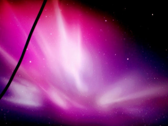

Hi I'm connecting an external monitor to my macbook pro and am experiencing regular vertical lines throughout the external screen.
I've tried DVI-D and VGA. I've tried changing resolutions. I have taken a screen shot of the monitor but this screen shot shows a clear image.
Attached is a picture of what it looks like. Hard to spot as taken with my isight. (Ignore the cable hanging down).
Please help me out!
Thanks

Hey, thanks for the reply. I'm using a MBP 13" Mid 2009. 2.26ghz. Running the latest OS.
Are you sure it's the graphics card, because I took a screen capture of the external monitor, and that screen capture seemed okay, so surely what the graphics card is outputting is fine? Hopefully I'm wrong, because I really like this monitor!
Hmmm, what monitor is it. It's likely not the entire GPU then - could be the mini-DP (i think that's what the macbooks have) or the cable or the converter. I would check all your connections first, then move the monitor to another computer and see if it gets the same results and from there -

After testing with another computer, the display is exhibiting the same issue described above. HELP!
Can you test with a different cable on that other computer? It seems it may be a monitor issue - what monitor is it?
