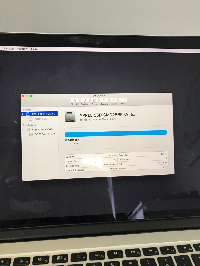

Ok - managed to get into the recovery system using cmd-r and First Aid on main SSD shows no issues but I still get the same thing.

Can I do a format and install using the online restore progress?
Just noticed my SSD is completely full, maybe that's the issue.
I know I had about 20GB free space before the issue started
Yes, just erase the boot volume in Disk Utility before installing.
Don't do this, of course, if any critical data on the drive is not backed up first because obviously it will be lost forever.

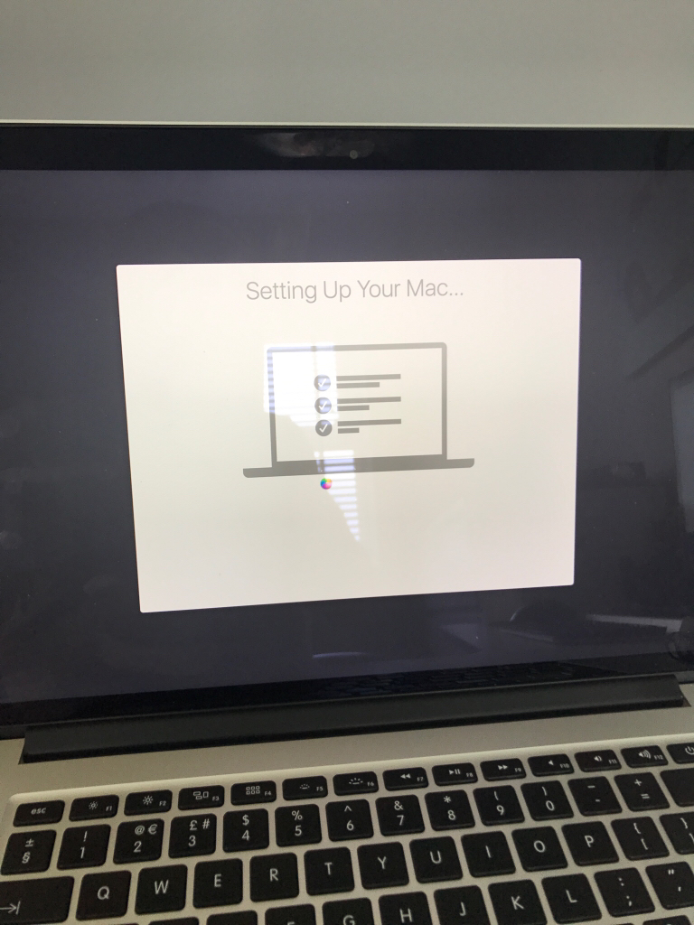

This isn't going well.
Formatted and going through a clean install but it's stuck here...
